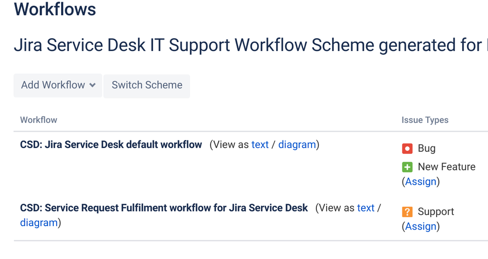

Yes, I'm in that role already. When you say to check the workflow, do you mean to click on Settings->Workflows? I assume you don't mean that.
I also tried removing this notification to the role and added notification to a single user (me). I then entered a new issue from the portal, and it still did not send me a notification.
The notification scheme shows it is "shared by 1 project" and the project is the one I want. But it is like the scheme is not activated, if there is such a thing.
Hi Jeff,
Yes I do mean take settings - workflow - edit and then look at the initial create transition.
Susan
I both really apologize for and appreciate all the time you're giving this newbie.
In worklfow under this project, I see these two and I believe they were defaults. They seem to make sense in terms of the issue status flow, but I don't see how this impacts the notifications because I thought "open" is part of issue created.

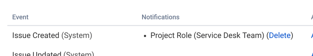

Hi Susan
I already have it set up to provide a notification to a role (Service Desk Team)... I think. See the attached screen-shot of this line.
Several internal users in that project have that role, yet have not been receiving this notification when an issue is created. So I assume there is something I didn't do right.
Any helpful suggestions?
