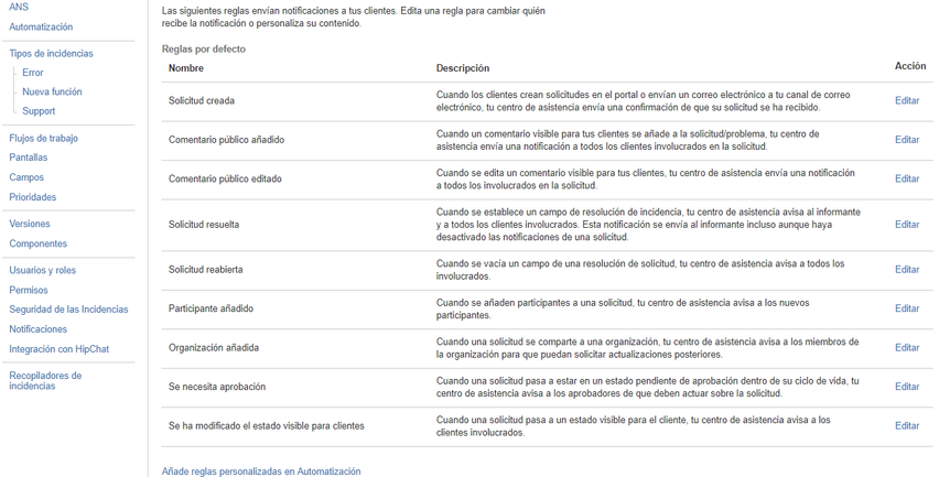

Hi all, i have a problem with notifications.
When a customer creates an issue, he is not notificated, despite i have al the settings ok.

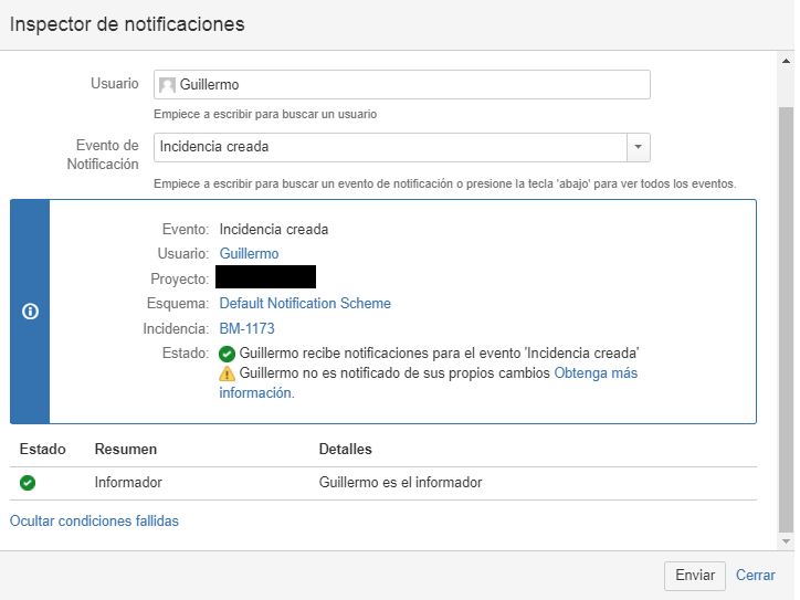

Also I made a test with the notifications inspector, but it says that´s ok

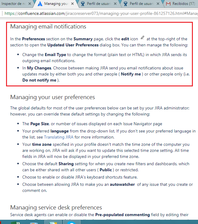

as you can see in you second screenshot you have disabled the function of getting notified of its own changes.
You can change this in the user profile. For more information you could also click the link shown in your screenshot.
Hope this helps.

After clicking the link, I have tried to follow the instructions:

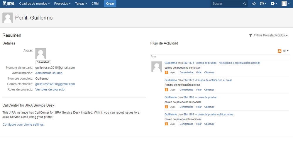

I couldnt find the "preferences section" on the customer profile, I think that section is only restricted for agents.
Regards.

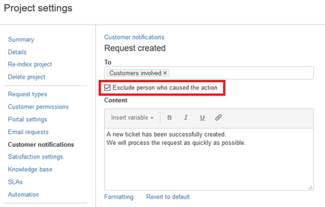

I checked the customer notification settings in our projects and noticed a checkbox to exclude the person causing the action. I think this is activated by default.
Make sure you do not have activated this checkbox.

Hi @H K
You are right, I unchecked this option and notifications started to working fine.

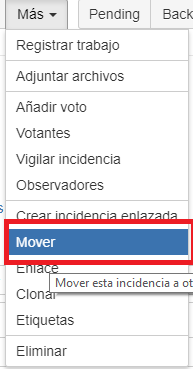

Hi @H K, I would like to share another related issue about notifications.
Keeping the notifications settings above, After I change the issue type using "moving issue type option":
Notifications about status updating are not sent (I suppouse could be probably about the incompatibility betwen workflows from an issue type to another).
However if I make a comment or give a resolution to that issue, those notifications are sent to the reporter.

okay. I was just a bit confused why you change this via the move option. I use this option to move the hole issue in another projekt. If I only want to change the type I just click on it and choose another one ;)

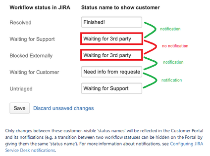

Nevertheless, without changing the project your notifications should still work as before. So only the notifications about a new status are missing, right?
Have you changed the names of the statuses visible for the customer in the portal
(under "project settings" - "request types" - "edit fields" of the now used request type - tab "workflow statuses")?

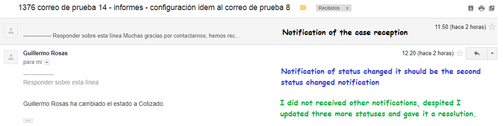

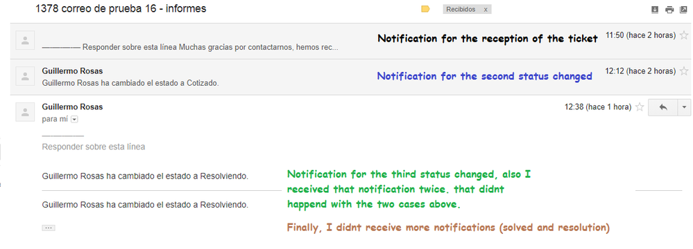

I have made a lot of tests (without moving Issue type yet, I mean keeping the same issue type), I realized sometimes customers are notificated, sometimes are not, sometimes are notificated twice (keeping  the same notification settings, considering visible and not visible statuses).
For instance I will show some cases (all those cases followed the same treatment with the same notification settings):
Case 1: The reporter did not receive notification of the change the status to "solved", neither the resolution notification
Case 2: I only received 1 notification :(, despite I updated all the statuses (the are 4 statuses that the customer can see, also I gave it a resolution "solved" that is no notificated).

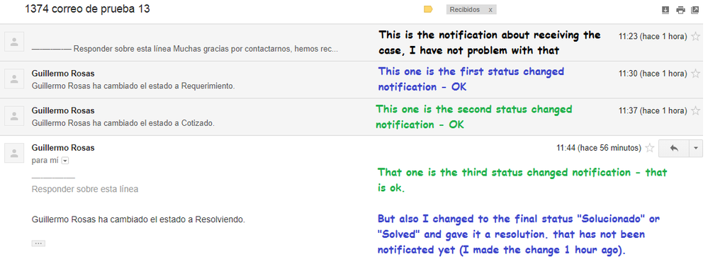

Case 3: I received a duplicate notification "resolving"
foto 3.pngI have more cases, I could think that is not a notification settings matter, because those cases had diferent behavior in the same treatment and settings conditions. I dont know what another feature could change those results.
