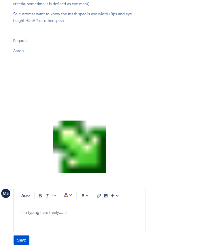

This software user, Marco, is indeed a participant, but he isn't in any organization in the SD project. When he replied he's not using the portal. However another user who's also a participant can only comment internally.  The screenshot below is what Marco sees when he comment.  There's no "Add internal note" indication and after he comment it will go public.

Thank you for the screenshot.

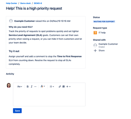

Marco is using the customer portal indeed, that’s why he can’t see the option to comment internally.
Here is the comment box of the customer portal:

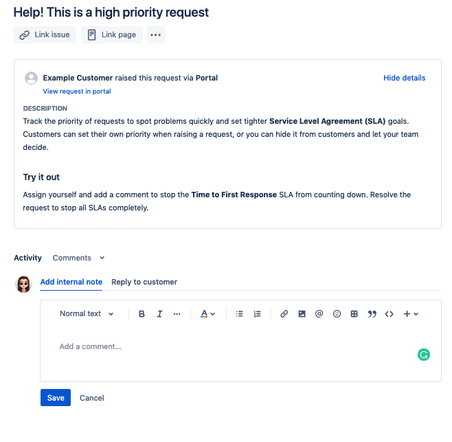

Here is the same ticket when viewing as an agent:
So, Marco needs to go to the ticket in the agent view (internally) in order to post an internal comment. Also, please, remove him from the Participants list, so he won’t be able to see the ticket in the portal anymore, he will only see the ticket internally.

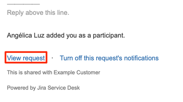

As he is a participant, he received a notification, so he could access the portal through the email:

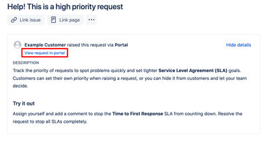

Also, he can access the portal directly through the ticket.
New issue view:
Old view:

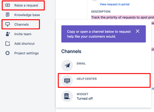

There are other options, but in this case, it's to go to the portal only and not directly to the ticket:
