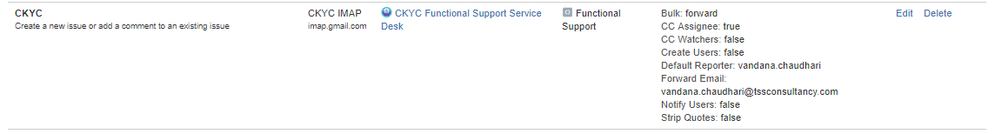

I have configured the incoming mail handler for one of our Service Desk projects but no tickets are being raised. We have external clients replying on the mail Id as well but no tickets are being created
-Mail server
-Handler
Also, earlier I had configured The Email request under Service Desk but that too didn't work.

Hi Mansi,
It appears that you are trying to use a Jira Core mail handler in order to create issues inside a Service Desk project of Jira.
This is a common misconfiguration.  While Jira Core allows you to add a mail handler to any project type, Service Desk projects typically can't use these in the way needed. This is because in order for Jira to be able to process these incoming messages, it has to make sure that the sender is a licensed Jira user.  In the case of Jira Service Desk customers, these users are unlicensed.  Which is why you can have an unlimited number of customers with Service Desk, but these users only have access to the customer portal (not the main Jira site).   As such Service Desk has its own mail handlers that can create issues for customers that need to be used for these kinds of projects.
I would recommend removing this Jira core mail handler first.  Then go back to the project settings of this service desk project and follow the steps in Jira Service Desk Server Documentation: Receiving requests by email.
I understand that you stated you previously had this setup but that it wasn't working either.  However this mail handler is the correct means to get email requests into Service Desk, and I would try to set this back up first.  We can then troubleshoot this further if it is continuing to not work correctly here.  We would want to make sure that no other mail handlers, in this Jira site or any other Jira site, are also using that exact same mailbox for checking messages.
