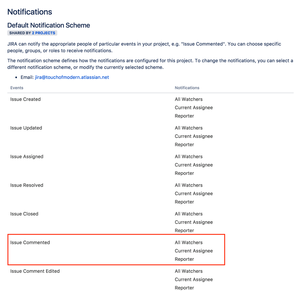

For yourself to receive notification - this will be in the Project Admin - Notifications.   Make sure that "Issue Commented" has "Current Assignee"

Hi Shepherd.  For the agent to get notified, this needs to be configured in the Project - Settings - Notifications.  The default Notification scheme should work as long as the agent is the assignee of the request.

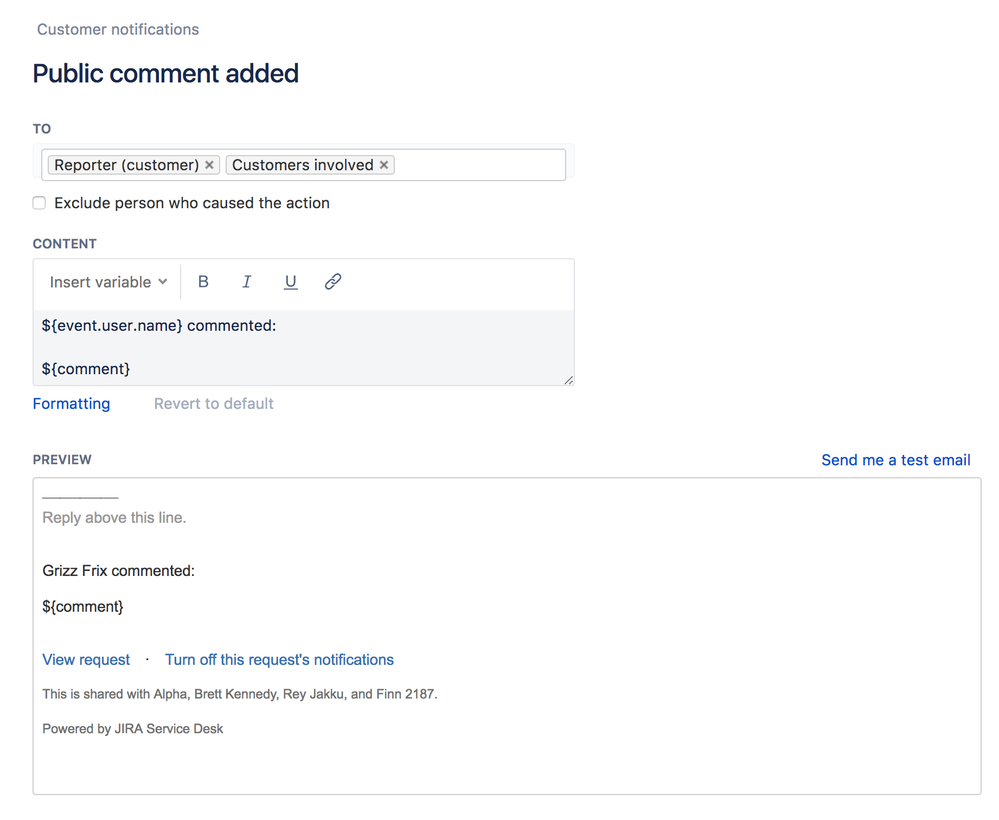

I went back to double-check my settings. They seemed the same as you suggested (please see screenshots below). Currently, the request is shared with an organization. Every customer (but not agents) in that org gets notifications when the request is commented.
Is there anything else that I'm not doing correctly?
Thanks!

That looks right.  And the issue is assigned to an agent and not just left unassigned?
For our service desk we customized the notification scheme so that issue created goes to the "Service Desk Team".  Maybe you want to add the Service Desk Team into comment added to see if anyone gets those notifications?
Otherwise I'm at a loss.
