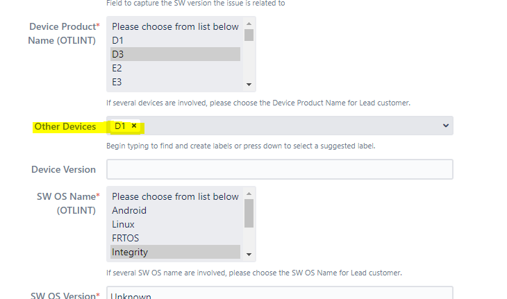

I would like to create Script Validator [ScriptRunner]' Validator for "Create" transition that will check the value filled in a custom filed "Other Devices" which is LABEL custom field,  when creating a new ticket.

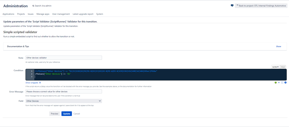

I have used a regular expression but it seems not working:
I have tested using this code:
cfValues["Other Devices"] == "D1|E2|V2H|H2|M2|M2-N|D3|E3|H3|H3-N|M3-W|M3-N|V3M|V3H|V3U|V4M|S4|V4H|Other|P926x"
It didn't work then I tried : cfValues["Other Devices"] == 'D1' and didn't work too.

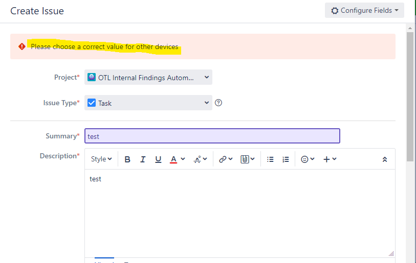

After adding your script, I did a test by adding D1 value to the custom field "Other devices" but the error message is shown.
I have added some screenshots to my answer.
Thank you again for help.

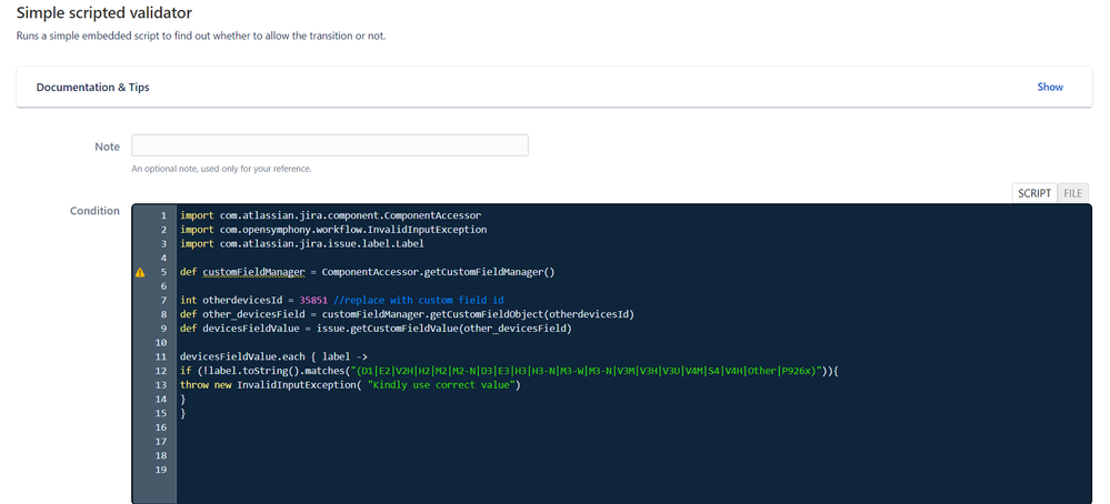

Hi @Vincent Leduby  Little change in script,
Tested on my side, it's working fine. Give it a try.
import com.atlassian.jira.component.ComponentAccessor
import com.opensymphony.workflow.InvalidInputException
import com.atlassian.jira.issue.label.Label
def customFieldManager = ComponentAccessor.getCustomFieldManager()
int otherdevicesId = 35851 //replace with custom field id
def other_devicesField = customFieldManager.getCustomFieldObject(otherdevicesId)
def devicesFieldValue = issue.getCustomFieldValue(other_devicesField)
devicesFieldValue.each { label ->
if (!label.toString().matches("(D1|E2|V2H|H2|M2|M2-N|D3|E3|H3|H3-N|M3-W|M3-N|V3M|V3H|V3U|V4M|S4|V4H|Other|P926x)")){
throw new InvalidInputException( "Kindly use correct value")
 Let me know the result. Hope it works for you!
