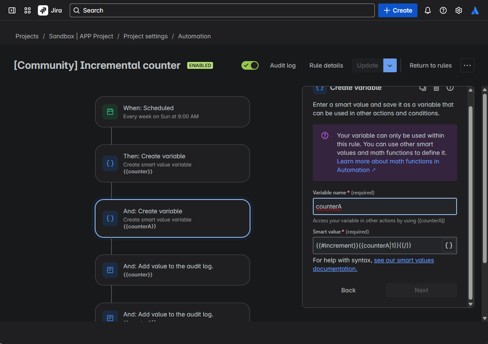

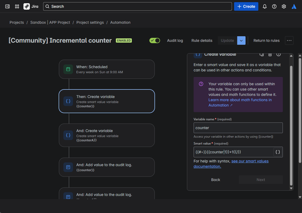

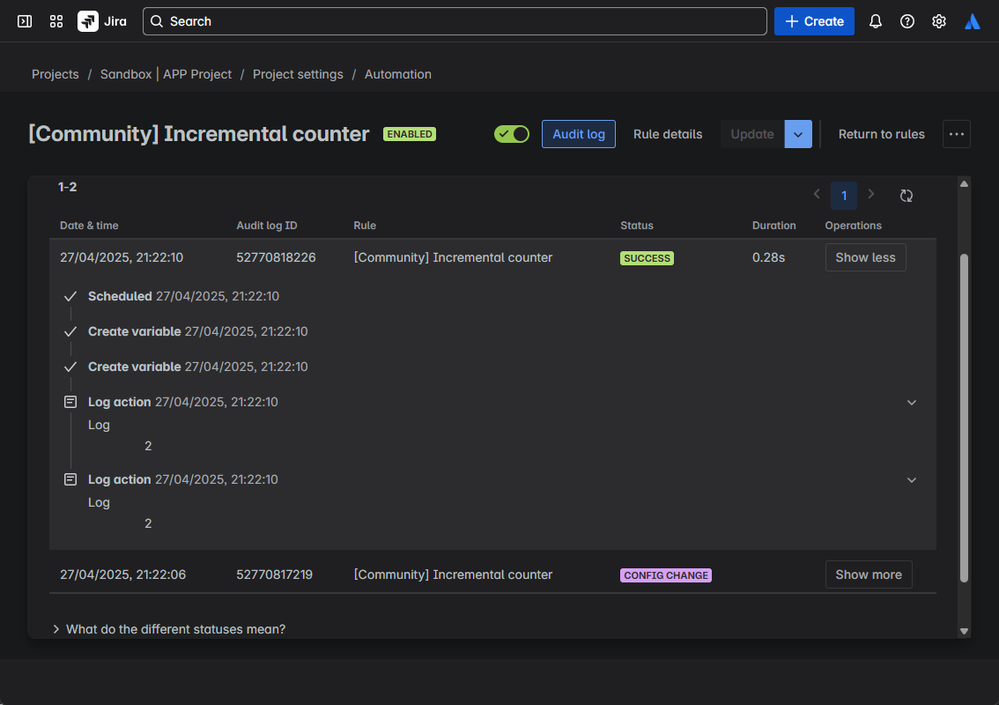

Hi @Altamash Heroli ,
I've just tested this approach and also tried using {{#increment}} and the value seems to update as expected.
I'm not sure why you're not getting anything to be displayed in the email table.
