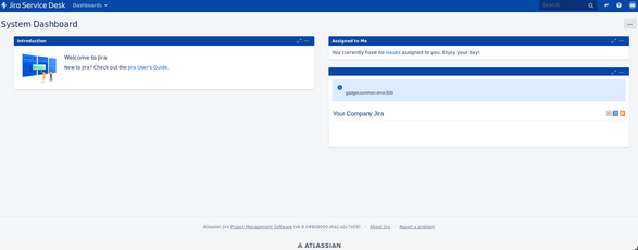

1. This Jira and it's database does not contain any data since newly installed and concidered testing atm. Because of that I did not back up the file unfortunately. Also still running in the built-in database. While waiting I also requested a new trial license which I am now "running", no important data in it though. The change I made initially was adding the text in bold below in the file '/var/atlassian/application-data/jira/dbconfig.xml':
<jdbc-datasource>
<url>jdbc:h2:file:/var/atlassian/application-data/jira/database/h2db?ssl=true</url>
That change is now undone & Jira restarted. After logging in I have no menus, etc for creating anything. jira-service-desk.pngAlso, in what would be the activity stream there is an error "gadget.common.error.500".

having corrected the misconfigured account, I now have a working Jira, using SSH (did not change anything) and the license expires 2022 which is about right. Really peculiar, but nice of course. Only thing left not working is the "gadget.common.error.500" error. Googling talks about a certificate not being correct. As SSL seems to work now... ?
Trying to create a dashboard revieled that the gadgets (which works at all) have peculiar names, starting and ending with underscore and punctuation in between. Surely not as should be. Same for some of the options in some gadgets I could actually add.

The most common cause for dashboard problems is the base URL configured in the application not being the same URL that Jira is actually serving itself from. If you're serving SSL now, that's probably the cause.
First, can you check your server.xml file to see what URL you're serving Jira from? If you configured a proxy URL, it should be the proxyName parameter.
Then in Jira, go to the General Configuration page in the administration. You need to make sure the Base URL field is the same URL that you've got configured in your server.xml file, and it needs to start with https:// (documentation for this here). A common cause for this error is having http instead of https in the base URL field.
If you're still seeing issues after that, it's possible that the Java runtime doesn't trust the certificate you're using. This might happen if you used a self-signed certificate or one from a certificate authority that isn't in Java's default keystore. If this is the case, you can use these instructions to import your SSL certificate into Java's keystore or let me know if you need help with this section.
