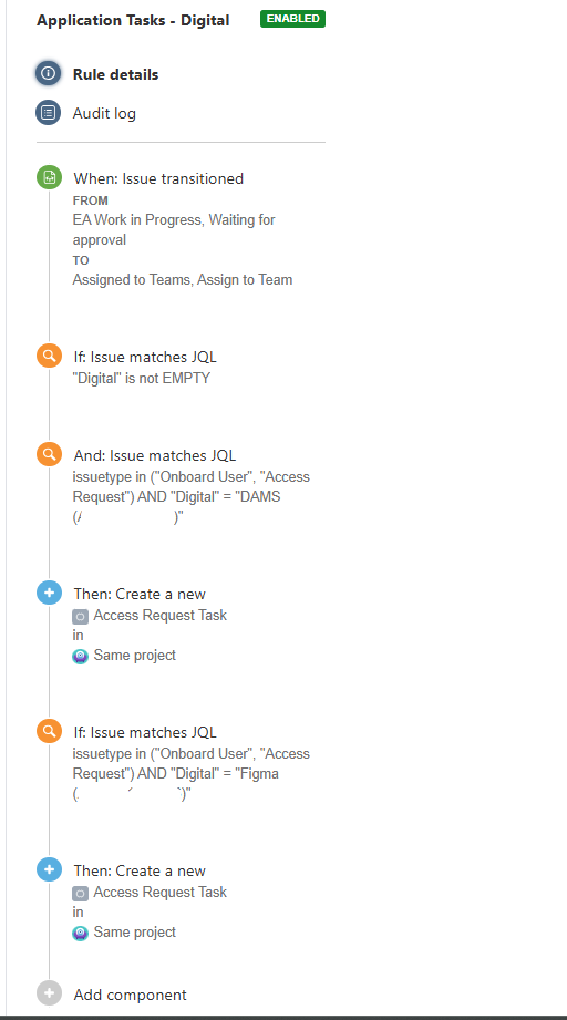

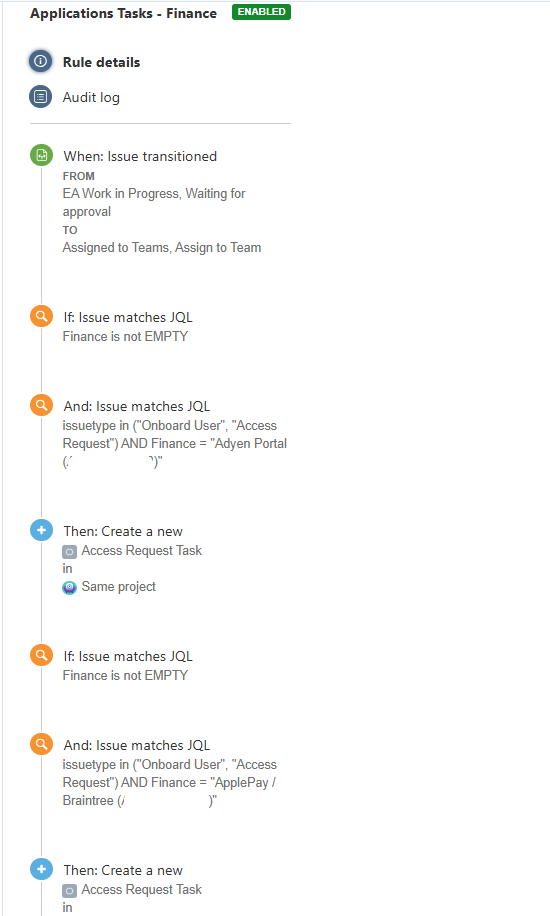

Hello! Any help is very much appreciated! I'm trying to make several automations for different applications under different request groups that aren't all selected at the same time or can all be selected at the same time. In this case, we need the automation to loop. There are several applications listed under different request groups. For this example, I've listed 3 below.
  • Finance includes - ApplePay & Adyen Portal
  • Digital includes - Figma and DAMS
  • Atlassian Suite includes - Wiki & Jira Software
Expectation:
When creating these automations, we split them up by request group, but they all have the same trigger and are most likely running on the same issue that was just transitioned. They are expected to all run and then populate sub-tasks based on which criteria they met. For instance, if the user selects Adyen Portal from Finance and then Wiki from Atlassian Suite, two sub-tasks should be created on the parent issue. One being Adyen Portal & the other Wiki.
Problem: It will ONLY create sub-tasks for the 2nd, 3rd, and so forth conditions if the 1st condition is selected by the user. It does not continue down or loop. The automation will run, but skips some applications or request groups all together. For instance, if the user selects Adyen Portal from Finance and Jira Service Desk from Jira, the only sub-task that is created is Jira Service Desk. It skips Finance because Adyen Portal is listed 2nd in the automation, but will create the sub-tasks for Jira Service Desk because it is listed first in the automation.
Troubleshooting:
  1. Adding in the re-fetch issue data between IF conditions, but this made no difference.
  2. Using IF and then IF/Else
  3. Adding IF between each each condition and then an AND condition.

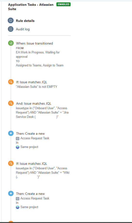

Current Automations
Example of Troubleshooting 3

Hi @Savannah Davis
This is because you are using IF instead of IF/else.
with IF if one condition matches, will skip the other.
you need to use IF/else.
Regards
Aaron

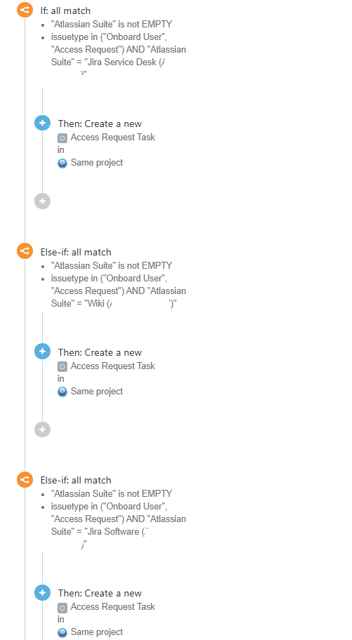

I have added in the IF/Else to one of the automations and tested it. See the new automation below. When testing it, I chose Wiki & Jira Software as they are 2nd & 3rd in the automation. A sub-task for Wiki was created, but no sub-task for Jira Software was created. How can we update this so that both sub-tasks are created here?
Like Samantha Matthews likes this
Aaron Pavez _ServiceRocket_
November 14, 2024
Hi again!
Now I get the full picture and what you need to achieve.
Sadly the if/else will work just the same, once one of them is TRUE then it doesn't go into the other IFs.

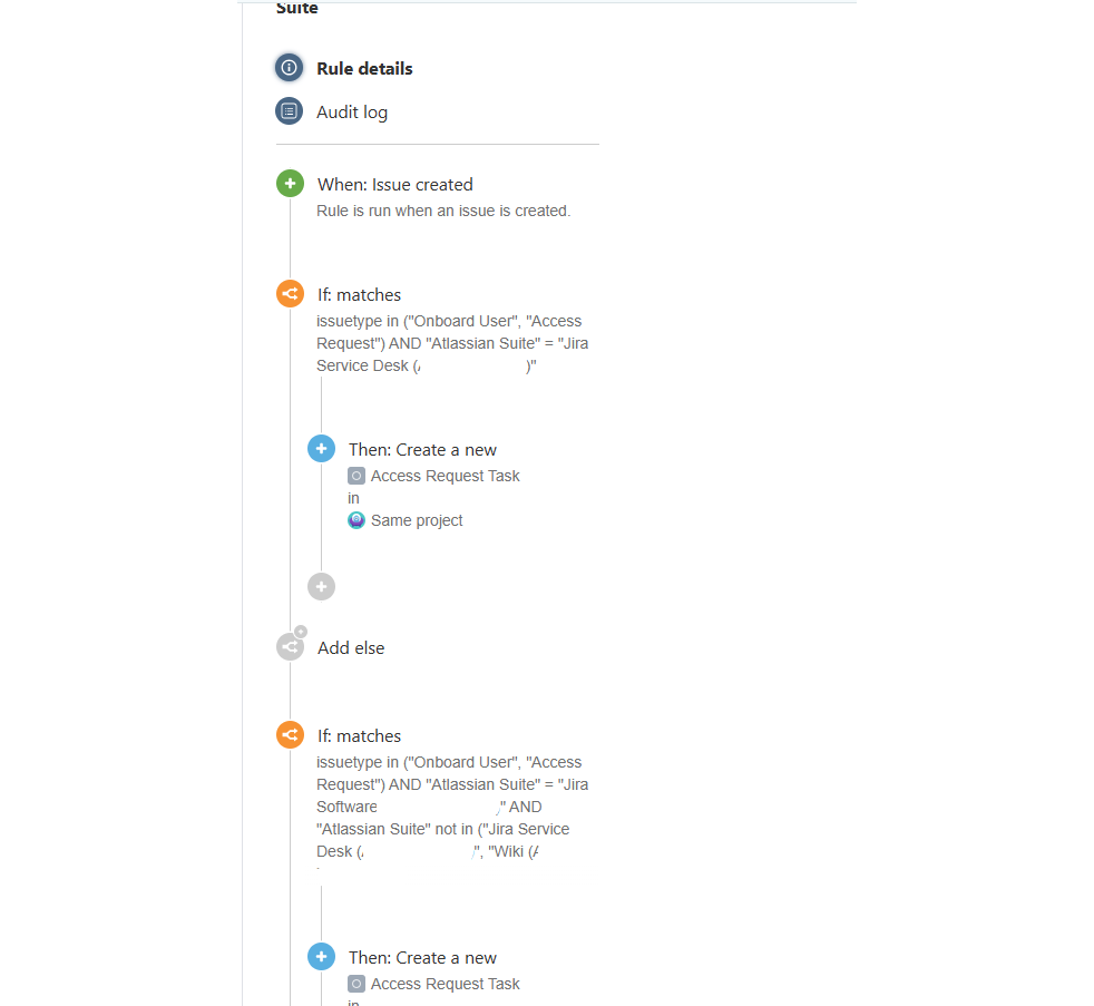

Hi @Aaron Pavez _ServiceRocket_ Thanks for the response! I have tried to implement this and I'm still finding that no issues are created (I did update the trigger to Issue Created from Transition to save time when testing this). Could you take a look over these? Thanks!

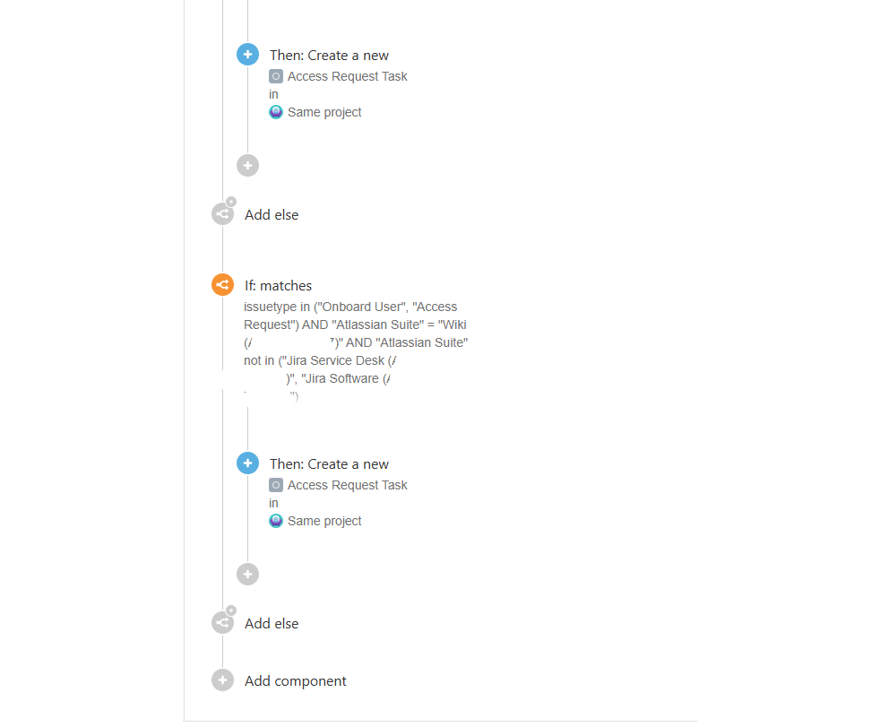

IF issuetype in ("Onboard User", "Access Request") AND "Atlassian Suite" = "Jira Service Desk (ASSET-)"
THEN Create Issue
IF issuetype in ("Onboard User", "Access Request") AND "Atlassian Suite" = "Jira Software (ASSET-)" AND "Atlassian Suite" not in ("Jira Service Desk (ASSET-)", "Wiki (ASSET-)")
THEN Create Issue
IF issuetype in ("Onboard User", "Access Request") AND "Atlassian Suite" = "Wiki (ASSET-)" AND "Atlassian Suite" not in ("Jira Service Desk (ASSET-)", "Jira Software (ASSET-)")
THEN Create Issue

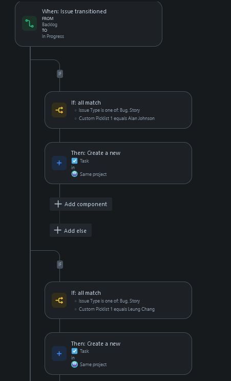

November 20, 2024
Hi Again!
If I understand correctly:
2 issue types = Onboard user and Access request. this remains the same
One "picklist"? = This is the one that changes and you create the Task based on this picklist.
This should work:
2024-11-20 16_50_18-Audit log - Automation - CaseSF - Jira — Mozilla Firefox.jpg
Notice the IF before the IF. That's what you are missing.
2024-11-20 16_51_09-Audit log - Automation - CaseSF - Jira — Mozilla Firefox.jpg
Regards
Aaron
Like Savannah Davis likes this
