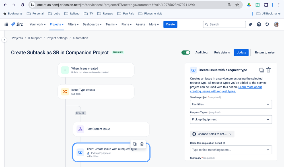

I was able to get something to work using automation. Basically, on the Sub-task issue creation, to specify the issue type, you can also add other conditions, like the Summary, etc.
Then I used a branch and the action "create an issue with a request type" because you will need to transform the Sub-task into an independent issue type in order to move it and enable it to be realized in the other project. All I am doing here is the creation and copying the Summary, but you could copy and / or set other field values.
I used this rule as a blueprint https://www.atlassian.com/software/jira/automation-template-library#/rule/1357127/25938462 . I always recommend people who are new to Automation to check out this library that Atlassian makes available exactly for this reason. For me, it is very helpful to structure the approach you need to use to make the rules do what you want them to.
