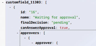

Hauke Bruno Wollentin
January 16, 2020
I looked for the same kind of ID.
After inspecting an issue by its JSON object via https://jira.example.com/rest/api/latest/issue/FOO-1234 I saw that the whole approval is mapped to or saved in an custom field.
The ID in the URL is the ID of the approval, e.g.:
The approval link for the issue above would be https://jira.example.com/servicedesk/customer/user/approval-action/FOO-1234/16/approve
Hope that helps someone :)
