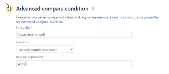

Add a check if there is a reference number in the description
image.pngIf not the rule should not execute further.

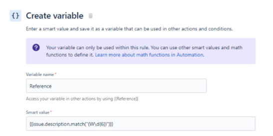

If there is a match you want to capture it in a variable

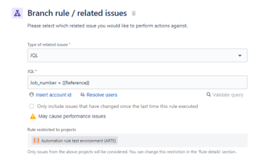

Now you have to have a main ticket in which you have a field that has the reference in it (in Khalid's case 'job number', in Josana's case the 'case number'). So we need to search for that ticket. Use a branch component and query on your reference field with the variable you just created:

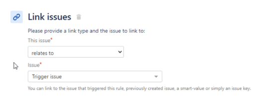

Finally you want to link it with the link issue component
That should do it.
