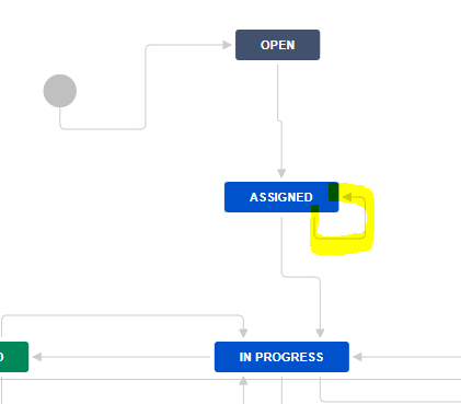

So if i understand correctly, I remove the questions that I want limited (Priority & Assignee) from the "Edit Screen". Then I add those to the transitions. And on the transitions, keep the condition so that only one user group can make them.
However, if I want to change the priority/assignee yet am not in a position to make a transition, then how would you suggest that I go about doing that?

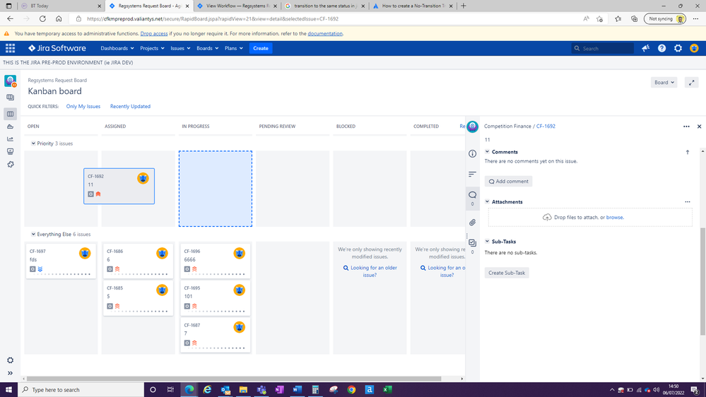

In the image below, I have shown part of my current workflow. I have created a transition from "Assigned" to "Assigned", and created a transition screen for that. However, when I try to move a ticket on the Board from Assigned, the only option available is "In Progress". When I drop the ticket back in "Assigned", the transition screen I created does not show up.

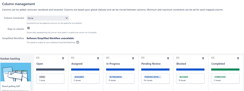

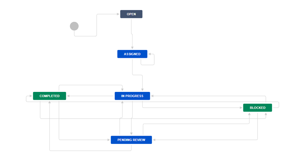

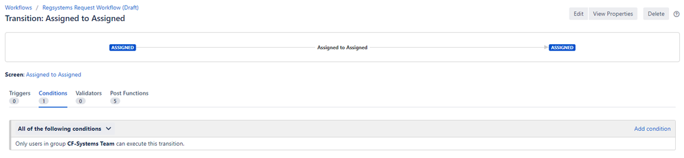

@Joseph Chung Yin  Thanks for offering to help and apologies for the delay.
Attached are three images
1. WF statuses
2. 'Board Column Management' to show WF status mappings to my board columns
3. Transition condition configuration - I've shared the configuration for the transition that goes from "assigned" to "assigned" (one condition that only 1 user group can move tickets)
 Be very good to get your thoughts on how users can change the priority/assignee without making a transition, if those questions only exist on a transition screen.

From the board, you will not be able to triggered "Assigned" to "Assigned" itself transition.  However, you can access the issue directly and from the issue view UI, you will be able to conduct the transition.  Your condition setup is correct.
The only way to can achieve controlling priority/assignee fields update  (Meaning without using the WF + making the them updatable only for your specific group's members - You can take a look at Script Runner for Jira 3rd party add-on via Behavior component configuration (Note this component is currently only available for server based env and not for the Cloud env) - https://marketplace.atlassian.com/apps/6820/scriptrunner-for-jira?hosting=datacenter&tab=overview
