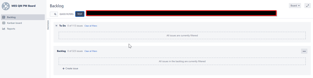

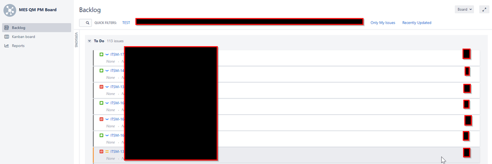

We are using the Kanban Board to show other group members what we are actually working on. Additionally to the four columns "to do", "in progress", "on hold" and "done" we want to have either one more column with all unassigned tickets from diverse projects or using the Backlog to show these tickets.
Right now In the Backlog we can see lots of tickets but they are all assigned. If I activate the test Quick filter, no ticket is shown any more. The auick filter test has this JQL statement: project = ITSM AND assignee = NULL
What do I need to change to see here all the tickets which have no assignee?

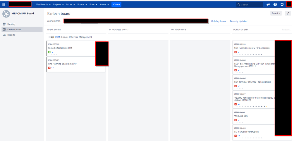

Rouven Maue
May 30, 2023
Hello John, thanks for your fast answer. Unfortunately still no Tickets are available. Not in Kanban Board nor in Backlog if I am using your statement.
If I try project = ITSM AND assignee = my name it is working fine. So it seems he is not able to determine if a ticket has no assignee?Board 3.png
