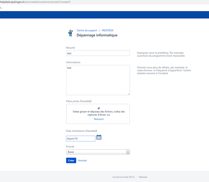

Tickets are only created though servie desk portal.
Notifications are working for service desk agents but not for users who only creating tickets.
No ticket creation alert, no ticket update alert.
Hope it helps.

Tickets are being created only through portal. (screenshot attached)
It's a service desk project, notifications are working for agent but not for users whose only creating tickets.
Hope it helps.
Regards.
