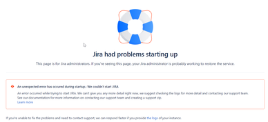

we got error as all user can't log in to jira service (username or password not correct), we restart the server to fix the issue
after restart we get different error as below
we checked the log from jira in server we found this error

You need to read the log again, looking for the actual error that halted it (not warnings about logging)

I didn't find any error log file, i only find other warning

Nic Brough -Adaptavist-
March 8, 2021
That's warnings from later on, when it's trying to shut down.
You need to be reading the errors from where it's trying to start up.
