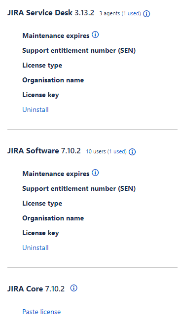

After update to 3.13.2 - Jira Service Desk is licensed but not currently installed

Kamardin Sergey
June 30, 2018
JIRA Core requires license.
Does it really need license?
Kamardin Sergey
June 30, 2018
We have done
truncate table pluginstate;

Jira Service Desk is working.
We work with any issuers.
It seems that only status report error.
