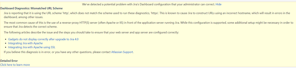

Hi,
I had upgraded the Jira Service Desk server from 3.7.0 to 4.4.3 version. My upgrade went well but i faced below issue on running the issue. I had configured server.xml file for HTTPS settings. I have not tried with marking secure = "false".
Can you please suggest how can i resolve this issue? let me know if you need more details.
Thanks,
Suhas
Nic Brough -Adaptavist-
August 3, 2020
The error message is telling us that you have not configured the server.xml for https
Could you tell us what you have done in server.xml?
ssuhas91
August 3, 2020
Thanks Nic. My server.xml settings is below:
Please note: i have updated the proxy name appropriately. Kindly help me if I did any mistake here.
<?xml version="1.0" encoding="utf-8"?>

<Connector port="8080" relaxedPathChars="[]|" relaxedQueryChars="[]|{}^&#x5c;&#x60;&quot;&lt;&gt;"
maxThreads="150" minSpareThreads="25" connectionTimeout="20000" enableLookups="false"
maxHttpHeaderSize="8192" protocol="HTTP/1.1" useBodyEncodingForURI="true" redirectPort="8443"
acceptCount="100" disableUploadTimeout="true" bindOnInit="false" secure="true" scheme="https"
proxyName="myproxyname.domain.com" proxyPort="443"/>

ssuhas91
August 3, 2020
I have just changed the proxy server part in the server.xml file.
