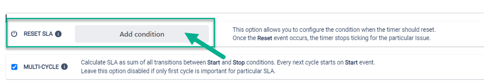

Hi
You can install an add-on SLA Time and Report from the Atlassian Marketplace.
This add-on has a reset SLA feature: In the configuration menu, you can select the condition for SLA Reset.
This option allows you to configure conditions when the SLA timer resets every time a specific condition is met and starts running again only when the Issue is on the Start condition.
Here, you can select a necessary condition from the list, except the ones you have added to the Start/Pause/Stop conditions. When you select this condition, the timer stops ticking for the particular Issue when the condition is met and starts ticking again after meeting the Start condition.

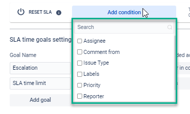

The list of the reset conditions depends on your project settings but can include only default Jira fields, such as:
  • Assignee
  • Comment from
  • Issue Type
  • Labels
  • Priority
  • Reporter Status
The application has a 30-day trial period and is free for small teams (up to 10 users), so you can check how well it suits you. My team developed it, so our support can help you with the settings.
