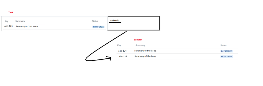

Hi,
I'm trying to pull subtask(s) within a task and display them in a dashboard I don't have access to ScriptRunner(I have seen is possible with this).
What I have is a query (that I'm inserting with "insert jira issue/filter" within confluence) that is pulling from a Jira kanban board all the tasks that are currently in progress and another query that is pulling the subtask(s) for a given manuallly added ID. Both querys do the job(picture attached) but I would love to have just one query(if posssible) and not to manually add the task ID to pull the subtask(s)
  • Query for task
    • project in ("ProjectName") and status in ( "In Progress") and issuetype in (task)
  • Query for subtask
    • issuekey in (childIssuesOf(abc-123)) and status in ("In Progress")
The idea that I have in mind is to add/show a column with the subtask(s) that are as well in progress for the parent task
I would appreciate your help on this one

@MFMM -
Unfortunately, it is not possible to achieve what you wanted out of the box.  You have to have an add-on such as ScriptRunner for Jira because the additional JQL functions that it provides.  Those additional JQL functions allow you to construct a single JQL statement.   In addition, it is not possible to list the resulting display in the UI that you provided in the image screenshot.
Sorry.
Best, Joseph Chung Yin

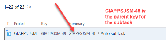

Joseph Chung Yin
December 16, 2022
@MFMM -
Looking at the posting you provide.  Yes, it is doable.  Essentially, it is adding a custom field to store the parent issue key and then it is populated by the automation for Jira rule setup.  Afterward, this becomes a part of your issue's metadata (i.e. for Subtask issues).
It is not ideal, since by default all subtasks' SUMMARY are already appended with the parent issue key.
Best, Joseph
