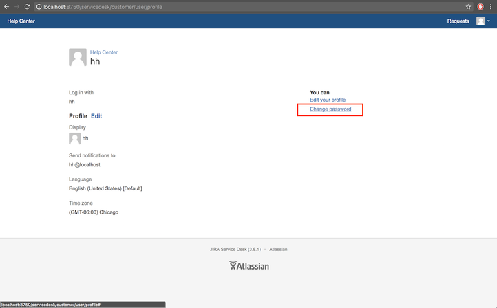

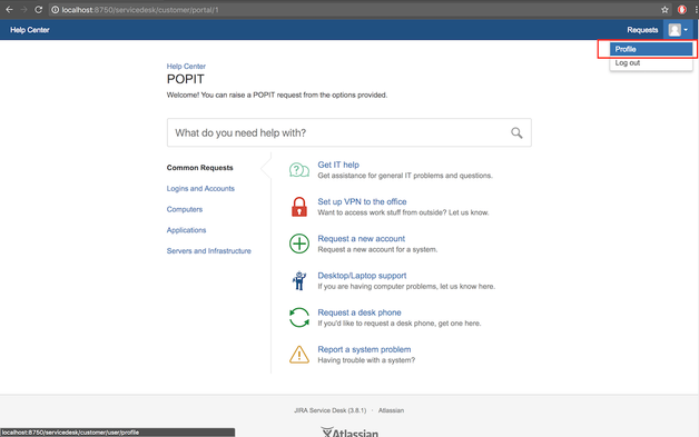

In the Jira webpage, the user would have to login to the customer portal first, from there they have to click on their profile:
That profile page is expected to have a reset password link there:
So this is possible to do. I even went back and tested this on a 7.4.2 Jira to make sure.
