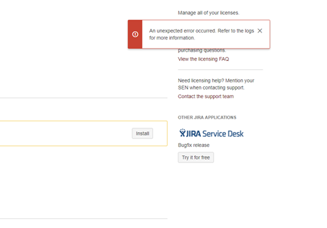

I had trying to install it but it through's the error refer to the logs for more information. We restarted too then also facing the same issue. The issue reflects in Log file.
2018-08-12 16:12:33,476 UpmAsynchronousTaskManager:thread-2 ERROR smareedu 520x456x1 rmusjl 192.168.2.175 /rest/plugins/1.0/ [c.a.u.core.install.ObrPluginInstallHandler] OBR resolver has 1 unsatisfied requirements for installing plugin.2659207046545861855.jira-servicedesk-application-3.12.2.obr
2018-08-12 16:12:33,476 UpmAsynchronousTaskManager:thread-2 ERROR smareedu 520x456x1 rmusjl 192.168.2.175 /rest/plugins/1.0/ [c.a.u.core.install.ObrPluginInstallHandler] Unsatisfied requirement: (&(symbolicname=com.atlassian.servicedesk.public-rest-api)(version>=3.12.2.REL-0009))
2018-08-12 16:12:33,503 UpmAsynchronousTaskManager:thread-2 WARN smareedu 520x456x1 rmusjl 192.168.2.175 /rest/plugins/1.0/ [c.a.u.core.install.DefaultPluginInstallationService] Plugin installation failed: Failed to resolve plugin dependencies within OBR [plugin.2659207046545861855.jira-servicedesk-application-3.12.2.obr]. Please see the logs for more detailed information.
Can you let me know
