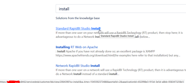

1. The first issue is that the Jira Service Desk seems to "inconsistently" use the Application Address (HTTP) when it should be using the Display address (HTTPS).  When you simply type into the Search bar in the customer portal, the service desk suggests links that are built correctly usingthe HTTPS address:

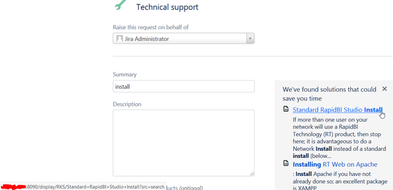

However, if you go into one of the categories like Technical Support, and then type into the Search bar, the links are incorrectly built with the HTTP (8090) address, and clicking on any of them to open is either blocked because of mixed content (behind our firewall) or is inaccessible (outside the firewall) - either way it would be much better if the window would not simply spin and give no indication to the user what the error is.

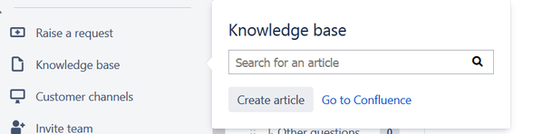

We tested with a new service desk and added a new link to Confluence and the HTTPS links are indeed always correctly built now, but despite what the online documentation says here https://confluence.atlassian.com/servicedeskcloud/set-up-a-knowledge-base-957150219.html there appears to no longer be a way to "unlink" the knowledge base from the help desk anymore?!?  We assume that simply deleting the link and rebuilding it will take care of the issue, but the only options are "Create Article" and "Go to Confluence" so we can't do that anymore, so what do we do to rebuild the link?

As for your 2nd question, this KB linking feature is built on top of the application link.  You need to have an application link between a Jira and Confluence in place before you could create this KB integration.  That said, if you want to remove this KB integration for that project, you can do so from within the Jira project settings -> Knowledge base link without the need to delete the application link entirely.  The URL for this page should be something like $JIRAURL/servicedesk/admin/{ProjectKey}/confluence-kb
Then just select the 'Don't link to a Confluence space'  This will remove the kb integration with this project without deleting the entire application link.

As far as the second part, that did work, thank you - simply deleting the link and then recreating it successfully builds both the link and what is embedded into the frame with https!
