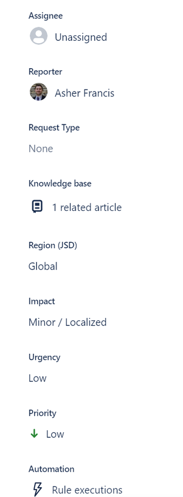

Hi
I'm trying to follow this guide https://confluence.atlassian.com/servicedeskcloud/configure-field-layout-in-the-issue-view-975038911.html as I need to change the layout of how fields appear in my issue types, however I do not have the "Issue layout" button in the project settings
It's a classic project.
The problem I'm trying to solve is that I have these fields here that are hidden and I want them to be higher up in the list
Any ideas?
Thanks

Hi Asher,
can you try clicking on the Configure button shown in your image?

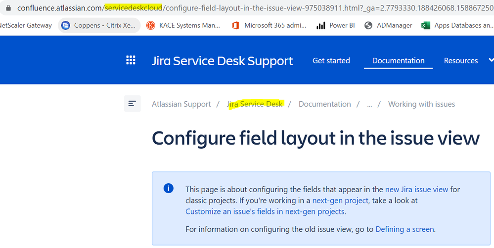

Asher Francis
May 7, 2020
If it's true that the "Issue layout" option is only for JSW then Atlassian need to update their documentation, as this advice is filed under Jira Service Desk!
I'm fairly new to JSD but I was under the impression that "Request types" were for issues logged by customers and Issue Types were to be used by service desk agents.
Is this not necessarily the case?

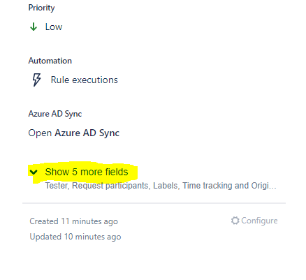

Asher Francis
May 7, 2020
All of them, but specifically I have a field called "Tester" which only appears for an issue type of "Change Request". The field appears but it's under the "Show more fields" option at the bottom.
I tried adding a request type but there are no request types associated with the Issue Type so I can't do it. I don't need a request type associated to the issue type, because it will be for internal use only.

Jack Brickey
May 7, 2020
regarding your "Tester" field I suspect it is under the "hidden when empty" section.

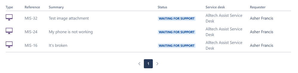

Unfortunately I haven't resolved the initial issue. I do not need a request type associated as the issue type is a "Change Request". This may have been created by a service agent, not a customer. Without an associated "Request Type", I cannot click the Configure button as when I hover over it, it says I have to have an associated request type in order to configure the layout.
I had thought this was the point of the "Screens". I have 5 issue types, each with a different screen and a different screen scheme.
Each screen scheme has the screen as the default for Create, Edit and View. I have ordered the fields in the "Screen" how I would like them, but this is not reflected when I view/edit the issue in JSD. It's fine when I Create an issue with that Issue Type, but when i go to edit, the fields down the right hand side do not match the Screen configuration.
With regards to the portal, the issue below called "Test image attachment" is set as a Change Request Issue type with no associated Request type
Asher Francis
May 7, 2020
It would be under the "Hidden when empty" section, only this configuration screen is only available for Request Types... not Issue Types! So it's not actually there at all, since there's no request type that contains that field, only an issue type.
Jack Brickey
May 7, 2020
I don't use Issuetypes w/o RTs in any JSD so haven't experienced this but it makes sense given Configure has implications beyond just the layout (request form, workflow statuses).
Workaround - associate a request type to the Change Request issue type. if you don't want the RT on the portal for whatever reason then place in the Hidden group.
In the old issue view Screens was the means to arrange order but in the new issue view this has changed for the view issue screen. Configure and Issue Layout are the methods now.
