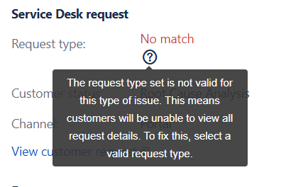

@Craig Haynal Thank you! You were correct about the mapping. I misunderstood your message initially and spent a long time trying to figure out how to correct our configuration in the Request types and Issue types sections of the Project settings. Perhaps there is a way that I am still missing.
However, I was able to solve this by manually changing both the Issue Type and the Request Type as you described. (When the service desk item is open in Jira, The Request Type is on the bottom right in the "Service Desk request" section of the classic view. When the Request type is incorrect, "No match" is shown in red with a question mark as shown below.)
If someone can identify a setting that I am missing, please chime in. Thanks!
