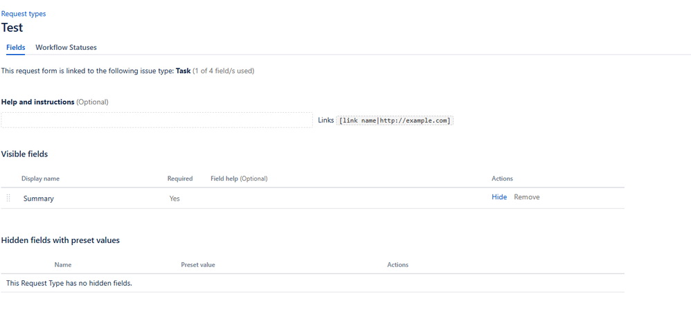

i mean this screen:

Hi @Krishnanand Nayak
To answer your question, it is possible to make a POST request to update the fields on a screen.
Something like:-
post("https://localhost:8080/rest/api/2/screens/addToDefault/10001")
You can refer to the REST API for Jira DC  for all the options avaiable.
I would suggest using the ScriptRunner Console along with the REST Endpoint, to include the fields.
Let me know if you need any help and I can try to provide an example code.
