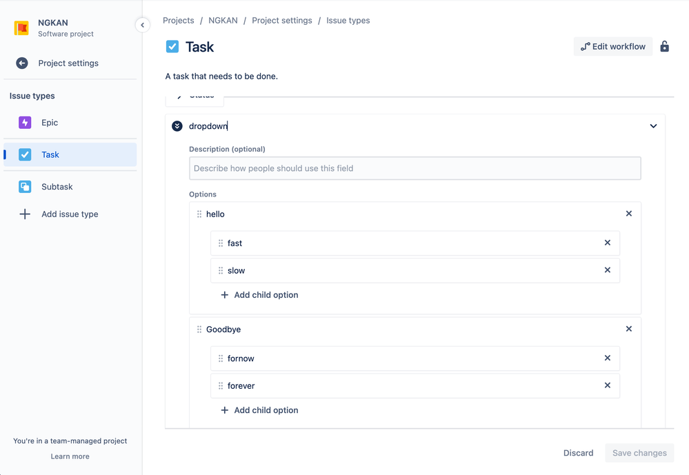

To see if I can better explain this, I created a dependent dropdown field in a team managed project, like so:

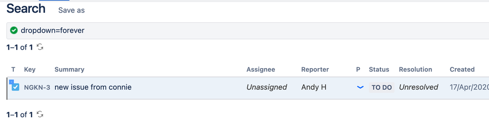

And then I assigned one issue a value1 of Goodbye, and value2 of forever.  From that point, instead of trying to look for a search such as dropdown=Goodbye.forever as I think you are purposing, in JQL you can just use a query of
dropdown=forever
and it will return that issue in the results.
I understand this is in the web interface, but since JQL behaves in the same way in the web as the REST API, you can use this same kind of query to find the data I think you are looking for here in most custom field cases.
In turn you can then make a REST call to the search endpoint
GET /rest/api/3/search?jql=dropdown=forever
And that can return to you all the issue in Jira with that field value that your account has access to view/browse.
