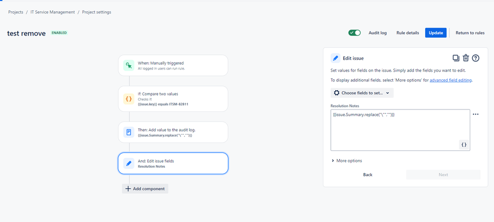

Vijay Dadi
October 14, 2024
{{issue.Summary.replace("\"","")}} - this worked for me. Give it a try.
need to use escape sequence for ".
Vj
