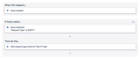

In this case, while this functionality is not implemented, the workaround would be using the Legacy Automation, where there is an action to update the request type.
I tested here creating a simple automation to clone an issue and the request type is empty on the cloned ticket, the same as you mentioned that happens on your site, but using the rule below, it will update the field as soon as the cloned ticket is created:
Please, give it a try and let us know how it goes.

Alexander
November 10, 2020
Hello Angélica,
I tried your solution and it works fine, thank you!
