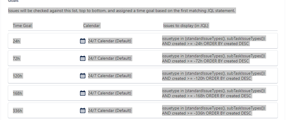

Michael Gomes
March 17, 2021
Hi Dirk,
Thanks for the quick reply. Please see attached below of the SLAs I created based on "Time to resolution". Now I want to sink them with the priorities mentioned above so that when we change the priorities from high to low, the SLA would trigger the time count down based on numbers of day(s). At the moment when I change the priority from low to high or vice-verse the time is still stuck on 24h. Hope this help you understand what I meant from the first question. Thank you

Hi @Michael Gomes ,
So on that SLA you can go to the "..." and click edit.
What defines the Time Goal linked to your issues would be the JQL at the end. If you want to sync these with the priority, you will also need to include the priorty in that JQL.
So for example:
issuetype in (standardIssueTypes(), subtaskIssueTypes()) AND Created >= -24h AND Priority = xxxx
The order by doesn't matter for the SLA goal (it doesn't do anything here).
I'm also wondering about your standardIssueTypes() and subtaskIssueTypes() in a single JQL. That would basically mean all issue types no?
So you might just rewrite these JQL's as
Created >= -24h AND Priority = your priority

Michael Gomes
March 17, 2021
Hi Dirk,
That was awesome, I just tested them all and it worked as you advised. Thank you so very much. I truly appreciate your help and very fast support. I am both impressed by your quick response and the right solution.
