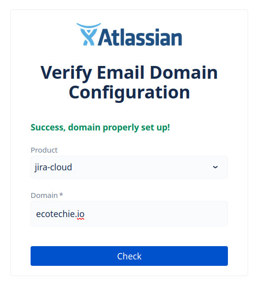

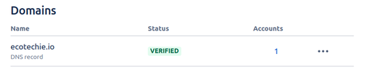

This is my current SFP1 configuration:
v=spf1 a mx include:spf.migadu.com include:_spf.atlassian.net ~all
The DKIM does not seem to save with the . at the end. They keep saving as s1._domainkey.atlassian.net not s1._domainkey.atlassian.net.
I'm using Cloudflare as the DNS provider.
All that, but the domain seems setup correctly:Screenshot_20200506_160141.pngScreenshot_20200506_160304.png

I checked and definitely had this work. There is an email invitation from the custom email domain on one of my inboxes that is on a completely separate domain.
But it does not seem to work reliably or at all anymore...
