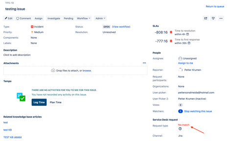

If my assumption above is correct, I believe the error above is happening because the issue ID that you are referring in the call is related to an issue that does was created internally and does not have a request mapped, as the one in the screenshot below:
Can you confirm if that's the case? Can you try to map it with a Request type and check if the REST API call works for you?
