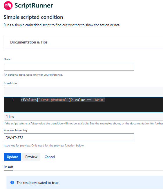

I have just tried the second example in a workflow and used the review function to verify it is working as expected.
In my example, there is a radio button field "Test protocol" with values "Ja", "Nein", "Nicht erforderlich". The issue DWHT has the value "Nein" set.
As you can see in the screenshot, the evaluation returns true:
cfValues['Test protocol']?.value == 'Nein'
This implementation means, that the transition is visible only if the value is set to "Nein". Otherwise it will be hidden.

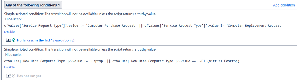

@Stefan Stadler - Please find the attached screenshot. The second one is not getting executed. The ticket that I was testing has the value "Laptop" but it's not hiding the transition.New Hire Computer Type.png

can you try to disable the first rule? You selected „any condition“ which means there is no need to execute if one already passed…

Hi @Stefan Stadler , this is working after using this condition -
!(cfValues['New Hire Computer Type']?.value in ['Laptop', 'Desktop'])
