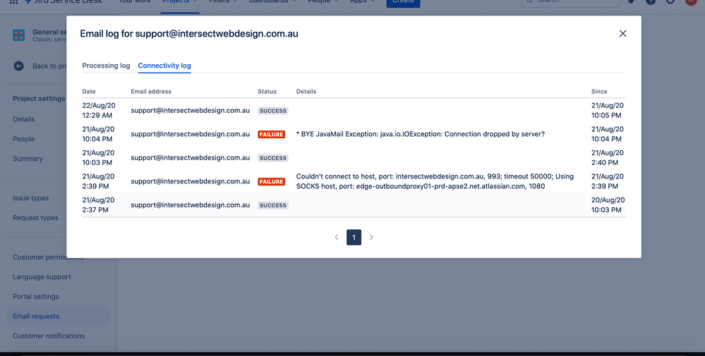

Stephen Thompson
August 21, 2020
Screen Shot 2020-08-22 at 12.30.18 am.pngThis is a screenshot of the log. It appears as though everything is connected. Not sure what's wrong. I can use the generic email, which does work, but I want my clients to use my support email address as they know it. Any other suggestions?
Angélica Luz
August 24, 2020
Thank you for the screenshot, Stephen.
There were issues with the connection, but it connected after one minute. If it shows it with more frequency then we will have to better investigate what is causing this.
Can you check the "Processing log" tab? That's the one that shows the error regarding the messages received by Jira.
