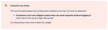

Sorry to hear about this problem. I can confirm that the widget can work with with the free versions of Jira Service Desk Cloud. However out of the box, there is a setting that needs to be enabled before this can work. Specifically there is a global setting to allow users to create requests without the need for them to login.
Check out Change global customer permissions. It explains in step #4 that you can choose if users do not need to be logged in order to send requests. You will need to set this to a value of Yes before you can create a widget within the project settings. If you don't then you should get an error message like this one:

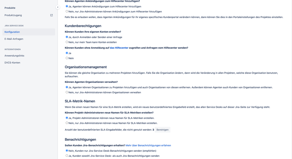

So I'm now a site admin as well. The settings are now as in the screenshot. There can only be one little thing now. Do you have another idea?
Sorry for the german translations. I think you can guess what is there.

Hi Jens,
That configuration page screenshot looks to be correct to me, thanks for posting that. I have limited tools into what I can see about your Cloud site configuration right now. I can see that you are a site-admin, but it still does not look like you are in the jira-servicedesk-users group from what I can see. This is the default user group for Agents in Service Desk. I'm confident that your account will need to be in that group in order to be able to setup this Service Desk specific feature.
