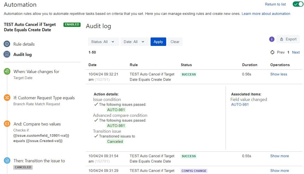

Here is a screenshot of my rule and audit log.

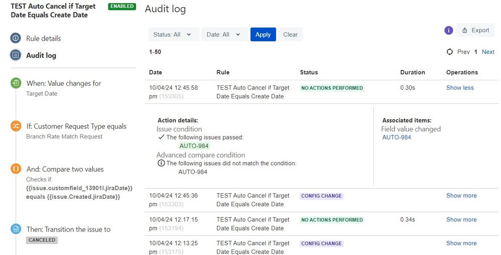

Bridget Caci
April 10, 2024
I removed the -val and created a test issue, with Target Date: 4/10/2024 and Create Date: today (4/10/2024).  But the status did not auto transition.

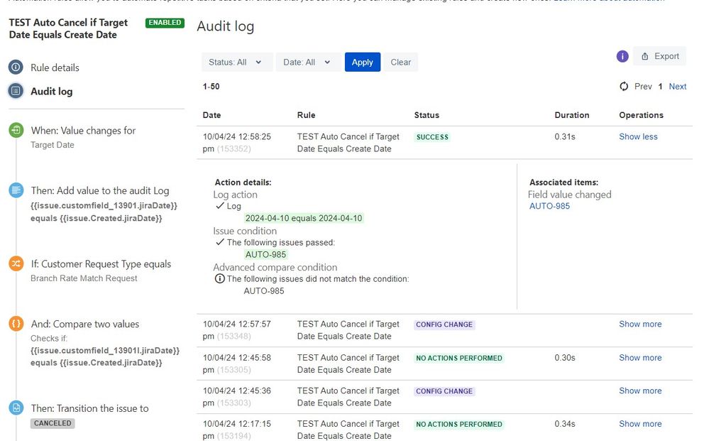

Kalyan Sattaluri
April 10, 2024
Hello @Bridget Caci
Please insert a log statement before your compare and log both values and share the audit log.
{{issue.customfield_13901.jiraDate}} equals {{issue.Created.jiraDate}}

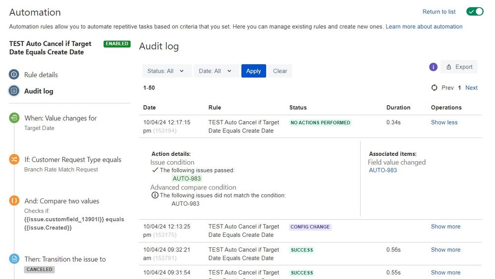

Bridget Caci
April 10, 2024
I haven't inserted a log statement before, so please let me know if I need to make changes.  As I have it written, it did not auto transition when I tested.

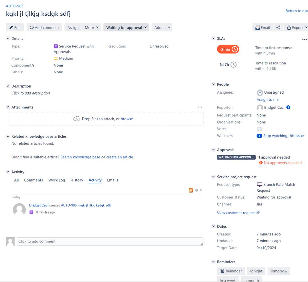

Bridget Caci
April 10, 2024
For reference, here is a screenshot of Auto-985.
Kalyan Sattaluri
April 10, 2024
Hello @Bridget Caci
As @John Funk has mentioned, you have a typo in your compare of If condition :p
Please revise it to:
And you did great with the log. Always log values so you know what values they hold.
Hope it helps and accept answer so it benefits others in the future. Thanks!!
Bridget Caci
April 10, 2024
This is perfect!  This is exactly what we needed - adding the log statement and fixing the typo.  We ran several tests and it worked properly each time.
Thank you all so so much for your help!
