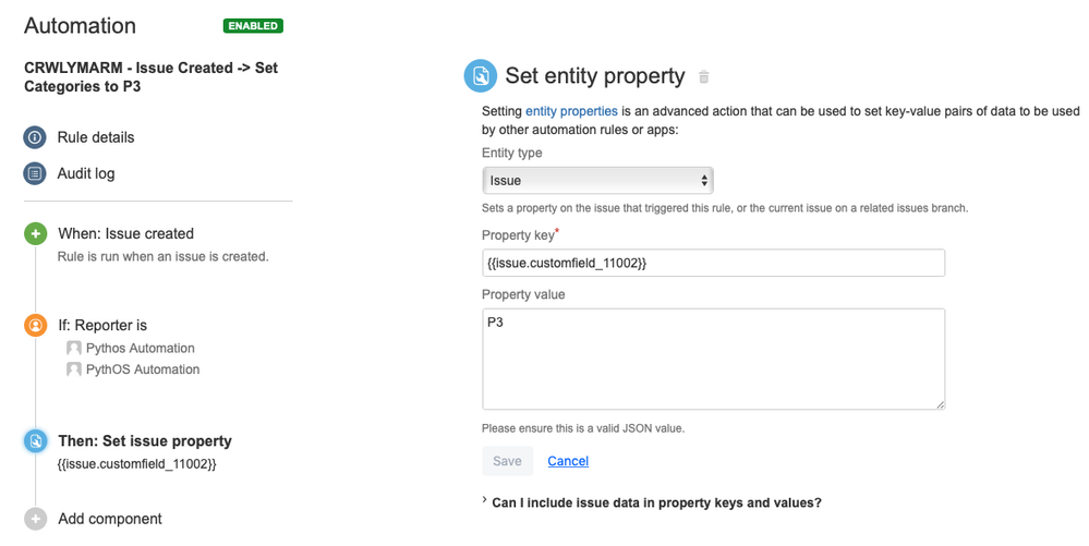

I have been trying since February 1st to work with my Jira support team to get automation working so that I can set a custom field on our Issues page to be automatically set -- I've dumbed down the automation to just have it set the "Categories" custom field to just be P3 for now until I get it working correctly, then I will add some additional logic to also read the Summary field to see if P1 or P2 is mentioned.
I have tried 42 different ways to get this to populate and nothing has worked -- below is a screenshot of my latest failure.  I know the custom field ID as well as the ID behind the P3 value.
Can anyone help me figure out how to get this to work so that I can move on?

Don't use set entity property but instead use the action for Edit Issue. Then you can select the field (sounds like you called it Categories) to set and what you want to set it to ("P3"). Properties for Jira issues are hidden items tied to an issue behind the scenes, and not something you would see in a custom field. Hope this helps.

Hi Ryan, I tried that as well but the custom field Categories doesn’t show on the Edit Issues - is there a way to get a custom field to show there?

There could be several reasons it wouldn't show up for the automation tool under an Edit Issue option. One of the best assists would be for you to go to that issue types Create screen and click on the Where is my field? helper. It should be somewhere in the upper right of the window for creating the issue. The reasons you might not see it could be: 1) It is out of scope (wasn't made available for that issue type), 2) Wasn't added to the Create screen for project / workflow it is in.  I believe there are a couple more but can't think of them off the top of my head so early in the morning. The Where is my Field? is a big helper though. You just enter the field you're looking for and it can likely point to what was overlooked.

Thanks again for your time Ryan.  I'm not an administrator so I can't see everything that goes on behind the scenes, but the Categories field shows up on the Create Issue and Edit Issues screens, but is not available in the Edit issue Automation.  Is there something specific I can tell my administrators to look for that they need to set for it to be available via Automation?

Let's see. It shows up on those screens for sure then so it is available for the project you're setting it up for and the right issue type.
Honestly, I see fields showing up in the drop down in automation that aren't even for the project I have a rule limited to. Software project fields showing up in service desk rule. Their context is global, but I tried editing the context to restrict to see if that might be affecting you. At least in my instance (jira server) I could still pull up the field.
Did the admins perform a re-index after creating the field? I am not sure what else might be causing it to not show up at this point.

Here's how I resolved:
Used the Project Automation, chose to do a new Edit issue action, but where I couldn't select the field, I could use the More options and entered the following into the additional fields text box:
"fields": {
"customfield_11002": [{"self":"https://jira.pythos.pythian.com/rest/api/2/customFieldOption/11070","value":"P3","id":"11070"}]
Tested it out and it worked!  Now I can write the logic to set it to other values based on the contents of the Summary field too!
