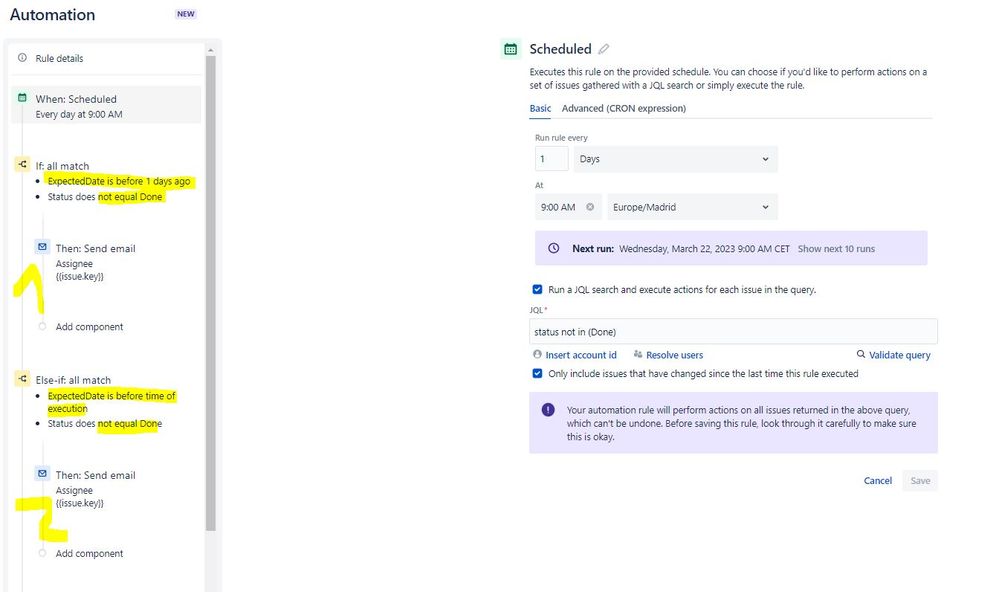

Juan Carlos Vera
March 21, 2023
Hi @serge calderara
ok, then i undestand that the advise is only for not DONE issues.
Can you try with something like this automation:
Regards ;)
