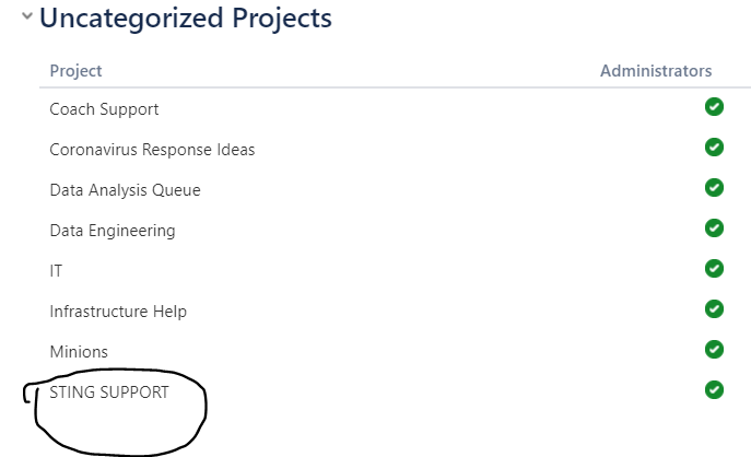

A site admin for Jira is showing up as an admin on a Jira service desk project even though they were never manually added to the project.
When I look at their profile and view their project roles I see they are listed as an admin on the service desk project.

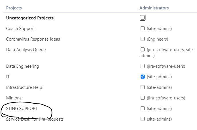

Yes. The first screen shot shows the projects this person is an admin for (STING support is the service desk project they shouldn't be an admin on). In the 2nd screen shot I try to edit project roles and it appears that the admin box is not checked for STING support.
@Paige Annunziato - weird! Could be caching?
Double-check using the permissions helper. Can the user do any admin-like features to that project?
Yes good question. He did have access on the permission helper, but I think the problem is fixed now. When I looked at the admin list under the service desk people settings I noticed the category site admin was on there, so I removed it.

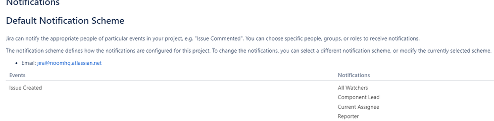

The same site admin was also automatically being added as a watcher for that service desk project. I believe that came from the 5.0 upgrade Jira had and I was able to help him change the watcher settings.
But something odd happened in addition to him automatically being added as a watcher on the ticket. When a service desk agent would go in and make comments on the ticket it wouldn't should the S.D.'s name as the person making these comments. It would show the site admin's name instead.
Any thoughts on why all the ticket updates would reflect in the site admin's name even though he didn't make any of the edits?
