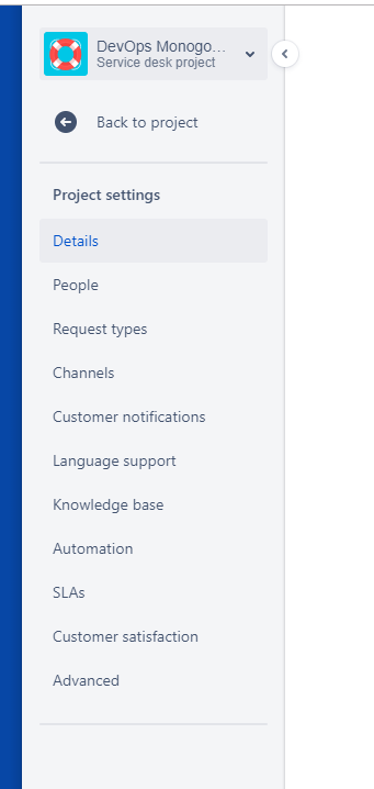

Could you please let me know how i can configure SD to work with Jira software? It could be an link to tutorial (i think i read everything but the tutorials either are out of date because there are different steps or this is not very clear).
(for example this link: https://support.atlassian.com/jira-service-desk-cloud/docs/give-other-jira-users-permission-to-comment-on-service-desk-issues/

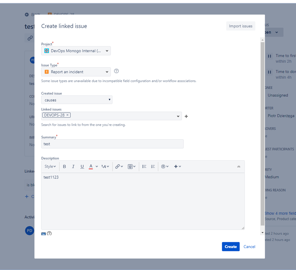

i did the app link between Jira (on prem) and Jira Service Desk (cloud).
Im able to Link issues From Jira (on prem) to Jira Service Desk (cloud) but im unable to create Issue From Jira Service Desk (cloud) to Jira (on Prem). In both systems i can see that the App link is created.
DO you know by any chance why? (on both systems im an administrator).
Earl McCutcheon
January 7, 2020
Hi @Piotr Dzierżęga ,
You will not be able to create the issues cross platform unfortunatly.  In the same way the transitions cannot be executed cross platform, the create issue action is technically a transition but a special one that transitions from a nonexistent starting location to the first status.
When the systems are connected via the app-link you can create a issue links between the systems but you cannot create an issue on the remote system.  This is also a feature we are tracking interest in at the following two links for the Server and Cloud platform respectively, make sure to add your vote to help in new feature prioritization efforts:
