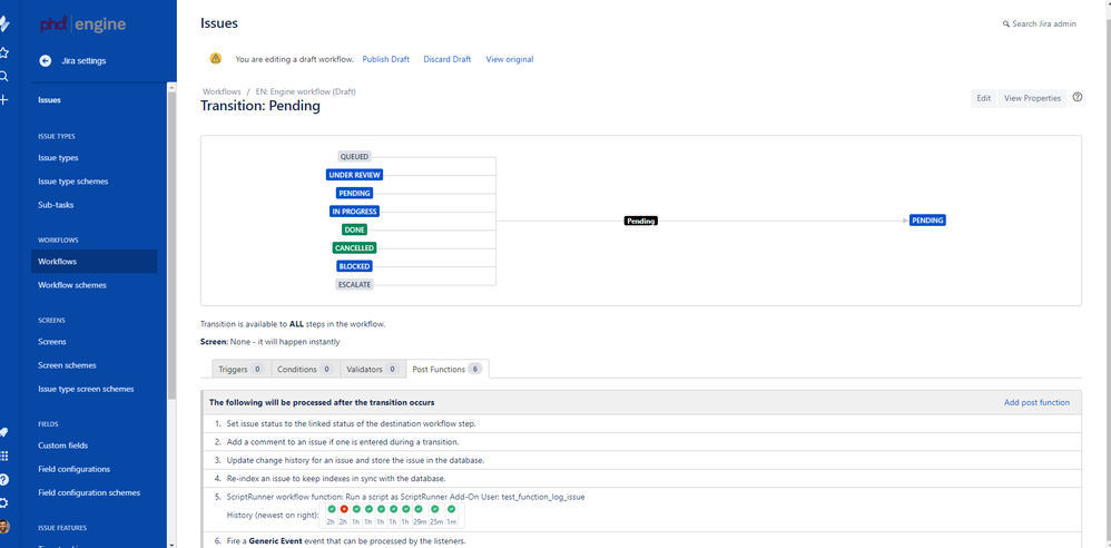

Hi Rajeev,
Can I please ask you to provide the screenshot of how your Post Function has been configured on the Create Transition of the workflow.
I can confirm that in order to access the values inside a post function on the Create Transition that you must order your post function to be the last one in the list below the post function named Re-index an issue to keep indexes in sync with the database.
The reason for this is that if it is not ordered below this post function then the field values will not be set on the issue so will return null and mean they cannot be used inside of your script.

Rajeev Gill January 29, 2020
Hi Kristian,
I am triggering this script on the pending transition not the create transition. This is so I do not have to create a new issue every time I want to trigger the script (This is for testing purposes and will be changed to create once I know the script works correctly)
This is how the PF is configured:
