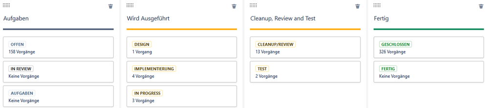

we don't find a way to see closed issues inside a Scrum board. We were searching for almost two weeks and we don't find an answer.
YYou can See there the Column "Fertig", which consists of "Geschlossen" (that are closed issues) and "Fertig" (that are finished or solved issues i suspect, but not closed).
Is there a way to show the closed issues in the column "fertig"?
As you can see in the Picture, in the Column "Fertig" are two possible issues which can be shown: The Issue "Fertig" inside the column named "Fertig" doesn't have processes. But there are also ~330 Issues of the category "Geschlossen" inside the column "Fertig", which could be shown.

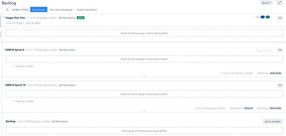

With the JQL Search there are no "Geschlossen" Issues in the backlog.
I think, closed issued aren't shown in the backlog and scrum board by default?

The project has some issues and this issues have a status.
The project has this board which is correct configured.
Inside the Column(Fertig), you have statuses! And this column then shows issues with these statuses.
The problem is that the issues of this specific project are in status = geschlossen and not in status = fertig and thats why you see under the status = fertig the note : keine vorgänge.
I think also that you misunderstand the Column name with the status name. Column holds any status that you want.
You say also: The Issue "Fertig" inside the column named "Fertig" doesn't have processesIt's not an issue... it is an issue with status = fertig
About the second part... Its logical i thing, not having a geschlossen issue in Backlog section , because its geschlossen/fertig/finished. Backlog is at the beginning of the production lane.
