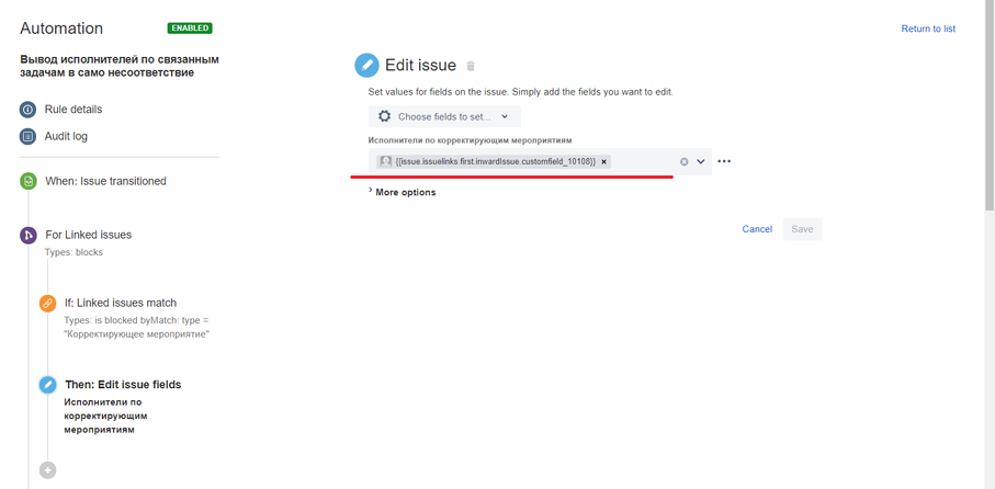

My project has 3 tasks. Two of it are linked with 3d by "is blocked by":
1. 1st's linked with 3d by "is blocked by";
2. 2nd's linked with 3d by "is blocked by";
3. 3d's linked with 1st and 2nd by "blocks".
I use {{issue.issuelinks.first.inwardIssue.customfield_id}} - Project Automation. But it returns only first linked issue field's value.
How to get all "is blocked by" linked issue field's value? Not the first value only?
Screenshot attached
On first view - it look like you have cicle, because in "conditions" you searched linked issues, then you just should edit them. (you are editing again linked issues). Maybe you right - depends on your case. Just advice.

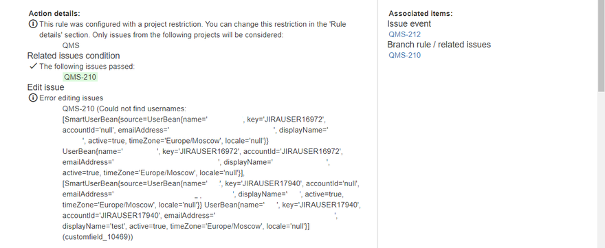

Не работает, если удалять first. Плагин выдает ошибку
Have you tried my first version?
Can you show screen with an error?
What do think about cicling, like I wrote before?
Because at the screen another mistake.
So I think my answer about syntax can be right.
