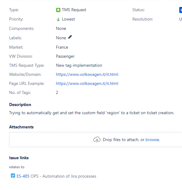

1. Get the value of the custom field 'Market' from the created issue
2. Depending on the value found in the 'Market' field
3. Create a new custom field on the created issue and populate the value of the new custom field
The problem I am having is getting the values of the custom fields (I haven't got as far as setting a new custom field yet.

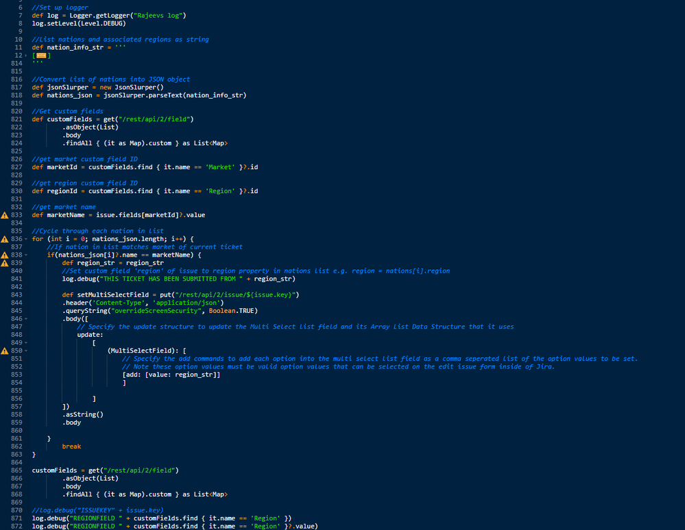

I am able to get the value of the 'Market' field but I am unable to set the value of the Region field.
When I try to set the value of the region field and then log that value it returns null, see code and log output below:
//Add libsimport org.apache.log4j.Loggerimport org.apache.log4j.Levelimport groovy.json.JsonSlurper
//Set up loggerdef log = Logger.getLogger("Rajeevs log")log.setLevel(Level.DEBUG)
//List nations and associated regions as stringdef nation_info_str = '''[
//A json list of nations (I left it out because it is too long)
//Convert list of nations into JSON objectdef jsonSlurper = new JsonSlurper()def nations_json = jsonSlurper.parseText(nation_info_str)
//Get custom fieldsdef customFields = get("/rest/api/2/field") .asObject(List) .body .findAll { (it as Map).custom } as List<Map>
//get market custom field IDdef marketId = customFields.find { it.name == 'Market' }?.id
//get region custom field IDdef regionId = customFields.find { it.name == 'Region' }?.id
//get market namedef marketName = issue.fields[marketId]?.value
//Cycle through each nation in listfor (int i = 0; nations_json.length; i++) { //If nation in list matches market of current ticket if(nations_json[i]?.name == marketName) { //Set custom field 'region' of issue to region property in nations list e.g. region = nations[i].region log.debug("THIS TICKET HAS BEEN SUBMITTED FROM " + nations_json[i]?.region) put("/rest/api/2/issue/${issue.key}") // .queryString("overrideScreenSecurity", Boolean.TRUE) .header("Content-Type", "application/json") .body([ fields:[ (regionId): nations_json[i]?.region ] ]) .asString() } break}
//log.debug("ISSUEKEY" + issue.key)log.debug("REGIONFIELD " + customFields.find { it.name == 'Region' })log.debug("REGIONFIELD " + customFields.find { it.name == 'Region' }?.value)
Log output
2020-01-29 13:58:07.001 INFO - Serializing object into 'interface java.util.List'2020-01-29 13:58:07.012 INFO - GET /rest/api/2/field asObject Request Duration: 540ms2020-01-29 13:58:07.344 INFO - Serializing object into 'interface java.util.List'2020-01-29 13:58:07.350 INFO - GET /rest/api/2/field asObject Request Duration: 299ms2020-01-29 13:58:07.410 DEBUG - REGIONFIELD [id:customfield_10179, key:customfield_10179, name:Region, custom:true, orderable:true, navigable:true, searchable:true, clauseNames:[cf[10179], Region], schema:[type:option, custom:com.atlassian.jira.plugin.system.customfieldtypes:select, customId:10179]]2020-01-29 13:58:07.412 DEBUG - REGIONFIELD null2020-01-29 13:58:07.430 INFO - Condition didn't eval to true, exiting
Do you know how to properly set a custom field value?

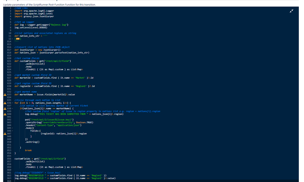

Hi Kristian,
Here is the full script:
def nation_info_str is a JSON list of nations which, which looks like this:
"name": "Guatemala",
"region": "LATAM"
A few points to note, you will see 'Region2' instead of 'Region' as in this version of the script I am testing a different custom field called 'Region2'
The 'Region' custom field is a multiple selection drop down box whereas 'Region2' is a simple single line text in put.
I've tried with both input field types with no success so far
Full size script image link: https://www.screencast.com/t/mdtb5bboJ
Hi Rajeev,
Thank you for your response.
I notice in your script screenshot that you are trying to just pass the JSON as the structure for the filed and this will not be valid for the text field you are setting as the text field requires the value you set to be a String which means you will need to convert the value to a string in order to be able to set it.
Finally, I can confirm we have an example script located here which shows the structure that should be used to set a single select list field which you can use as a reference as I can confirm we do not have an example of how to set a multi-select list field.

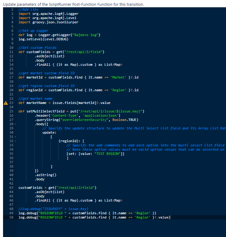

Hi Rajeev,
I can confirm I have just created the example code snippet located here and can confirm I have tested this and that when run on the script console this code snippet will populate a multi-select list field on an issue and will be a useful reference to show you how to refactor your script to set the multi-select list field.
I hope this helps.
Regards,
Kristian
Hi Kristian,
Thank you for the code snippet, it is much appreciated.
Can you confirm, this code snippet will enable me to update the value of the custom field, at first glance it seems as though it will just update the multi-select options the user can choose from.

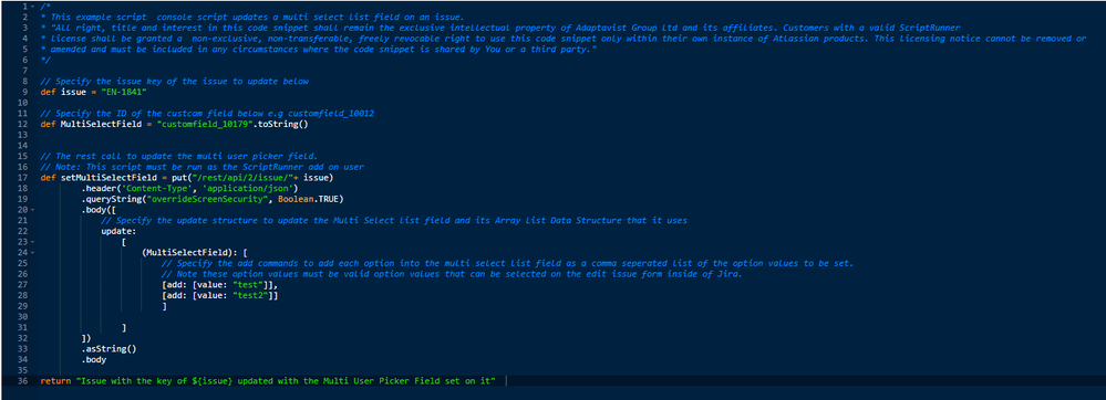

Kristian,
Which example shows how to set a custom field to an already configured option, the code example on bitbucket appears to only add additional custom field options for the user to select.
Thanks,
Rajeev
Hi Rajeev,
I can confirm the code example I shared which is located here will set the values on a multi-select list field.
I think you are misunderstanding the code as the add syntax is required to tell the rest the API to add one of the valid options available for the field to the selected options as it is a multi-select list field.
The reason for this is that the field may already have an option value selected and you may be selecting another value out of the valid options which exist for the field.
As mentioned previously this code will require you to specify a value which exists as Jira will not allow you to create a new option which is not valid for the field.
Please, note that I have tested this code myself and can confirm that this is a working example and will set the values if you run this on the script console specifying a valid issue, custom field ID and valid option values.

Hi Kristian,
I have run this script without errors however the 'Region' field remains 'null'
This is the log output
2020-01-31 13:13:06.309 INFO - Serializing object into 'interface java.util.List' 2020-01-31 13:13:06.842 INFO - GET /rest/api/2/field asObject Request Duration: 3537ms 2020-01-31 13:13:07.194 INFO - Serializing object into 'interface java.util.List' 2020-01-31 13:13:07.243 INFO - GET /rest/api/2/field asObject Request Duration: 337ms 2020-01-31 13:13:07.283 DEBUG - REGIONFIELD [id:customfield_10179, key:customfield_10179, name:Region, custom:true, orderable:true, navigable:true, searchable:true, clauseNames:[cf[10179], Region], schema:[type:option, custom:com.atlassian.jira.plugin.system.customfieldtypes:select, customId:10179]] 2020-01-31 13:13:07.304 DEBUG - REGIONFIELD null 2020-01-31 13:13:07.322 INFO - Condition didn't eval to true, exiting
I guess I am not making the API request in the correct format or with the correct parameters?
Thanks again for your support

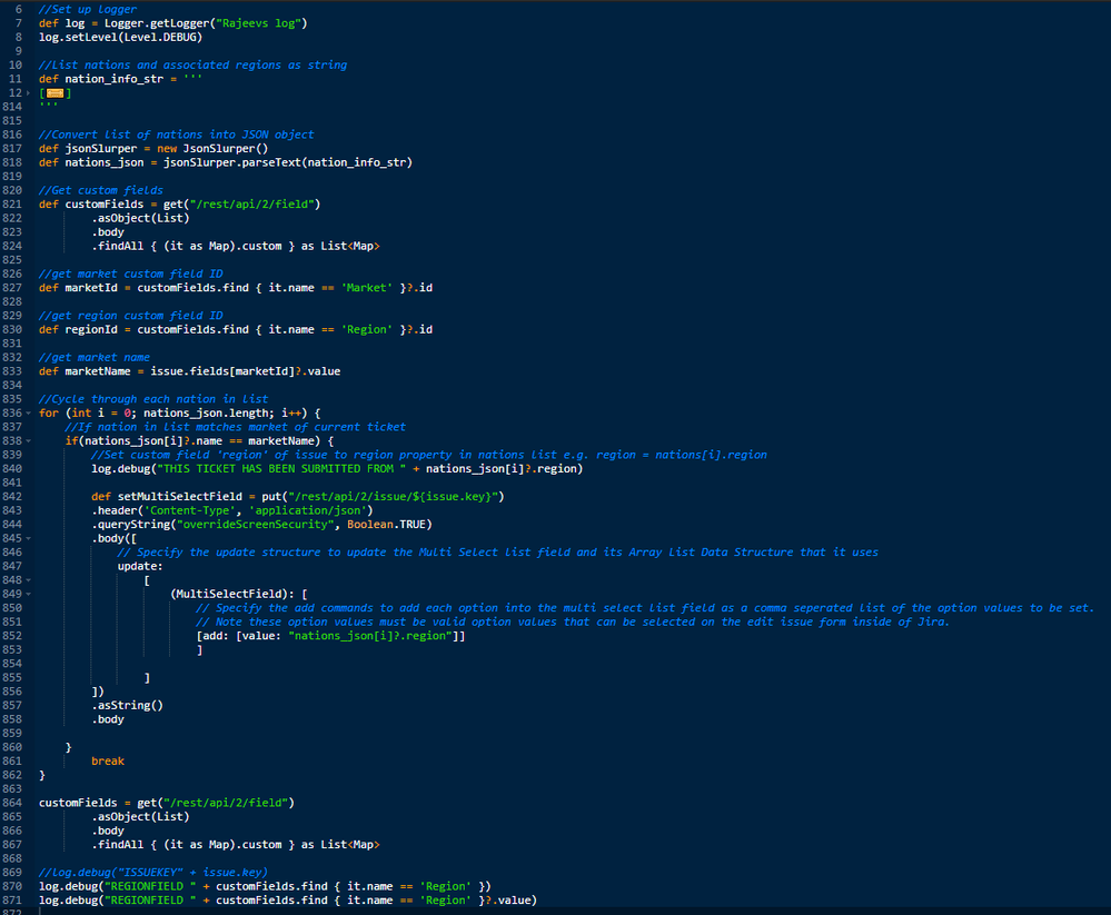

Hi Rajeev,
Looking at your screenshot I see the option you are trying to set is called nations_json[i]?.region and you have this in double-quotes which means you are telling the API to select an option with this name from the drop-down.
To me, this looks invalid as I am guessing you have not configured an option called nations_json[i]?.region.
If your script should be setting this to the value which is defined by this then you should create a new variable of type String which stores this value and you should set the option to this value.
In groovy when you pass a variable you would just pass its name e.g myVariable without having it quoted.
I hope this helps.
Kristian
Hi Kristian,
I've refactored the code to pass nations_json[i]?.region as a string, see screenshot below:
lI am still getting 'Null' when I check the 'Region' value on line 872
Hi Rajeev,
I can confirm that line 872 as shown in your screenshot appears to be a log statement and I believe the syntax of your log statement is invalid which is why it is logging out null.
I would advise trying to save the value of the field to a variable in your script as a String and then to just log out this variable to see what the value is.
Regards,
Kristian

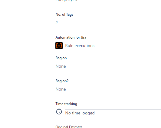

Hi Kristian,
Thank you for all of your help.
Unfortunately I am new to Groovy, this is the first time I have ever used it. Could you show me the correct way to log out the value of 'Region'?
I also checked the ticket I am using to test and can see that the 'Region' field is still null, see picture below:
Hi Rajeev,
I notice from your screenshot that the Region Field does not have a value, can you please confirm if this is from after you have run the script to set the value?
If this is the case from after you have set the value, then this shows that your logic is invalid as the value has not been set from your script and I would advise trying to hardcode setting a value in the field to test if your logic for your rest API call to set the region call is valid.

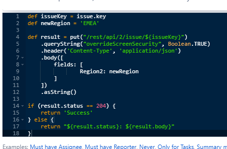

Hi Kristian,
I have tried using both examples to set 'Region' (MultiSelect) and 'Region2' (Text field)
The above code returns this error:
WARN - PUT request to /rest/api/2/issue/EN-1841 returned an error code: status: 400 - Bad Request
body: {"errorMessages":[],"errors":{"Region2":"Field 'Region2' cannot be set. It is not on the appropriate screen, or unknown."}}
The field 'Region2' has been added to every screen we have...
Do you have any idea how to get past this error?
thanks,
Rajeev

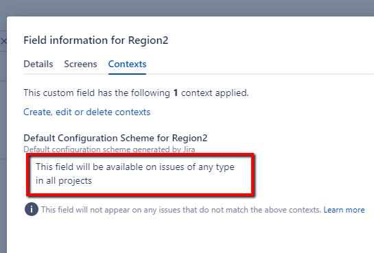

Hi Rajeev,
Can I please confirm if you have tried running the script as the ScriptRunner Add On User to see if this resolves your issue as you must run the ScriptRunner Add On User when you specify the overrideScreenSecurity queryString paramater inside of your rest call.
Also can I please ask that the context for the field defines that it is available for the issue type that your issue is using?
Regards,
Kristian
Hi Kristian,
I can confirm that script is running as ScriptRunner Add On User and can confirm that I am using the line .queryString("overrideScreenSecurity", Boolean.TRUE)
I can also confirm that this field can be used on all issues:
thank you!
Rajeev
Hi Rajeev,
Looking at your script I notice you are specifying the name of the field as Region2 but the API will require this field to be specified by its ID so can you specify by its custom field ID to see if this resolves the issue which you are seeing.
