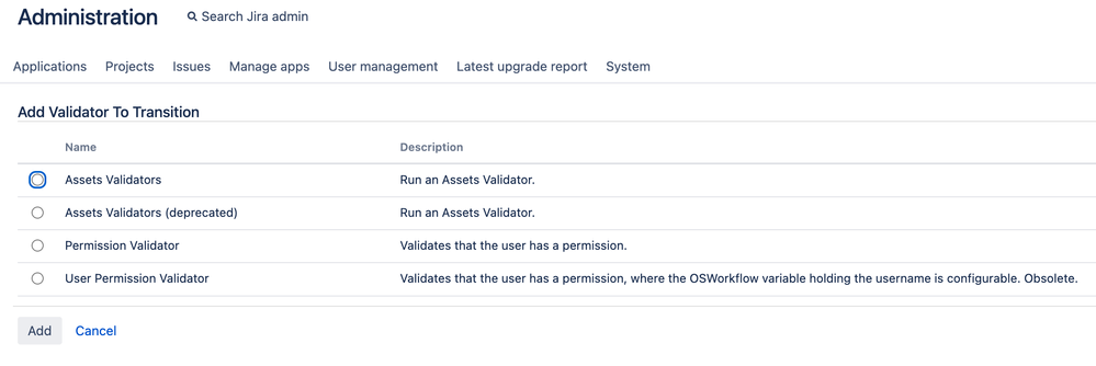

When checking the validator on a transition, I can't find "a field required validator".

Right, you are on Data Center 😅 ...
Yes indeed, this does not come out of the box there and even Atlassian recommends using an external workflow app from the marketplace to extend this capability, as you can read in the official support documentation.
If you need solid workflow configuration on Jira DC, having such a workflow extension added is actually a must. So I strongly recommend this.

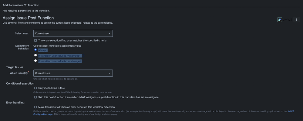

On the software our team works,  Jira Misc Workflow Extension (JMWE), you should be able to do expand this option, just add the function that will become available. Here is the configuration screen of said function:
You are able to assign it to either the current user, the reporter, lead, last commented user and so on, while also being able to set up custom conditions.
If you need something like field required validator are also available from it, so you should also be able to set the assignee field as mandatory before closing the ticket.
Please contact our support if you have any other questions about this validator, or JMWE in general.
