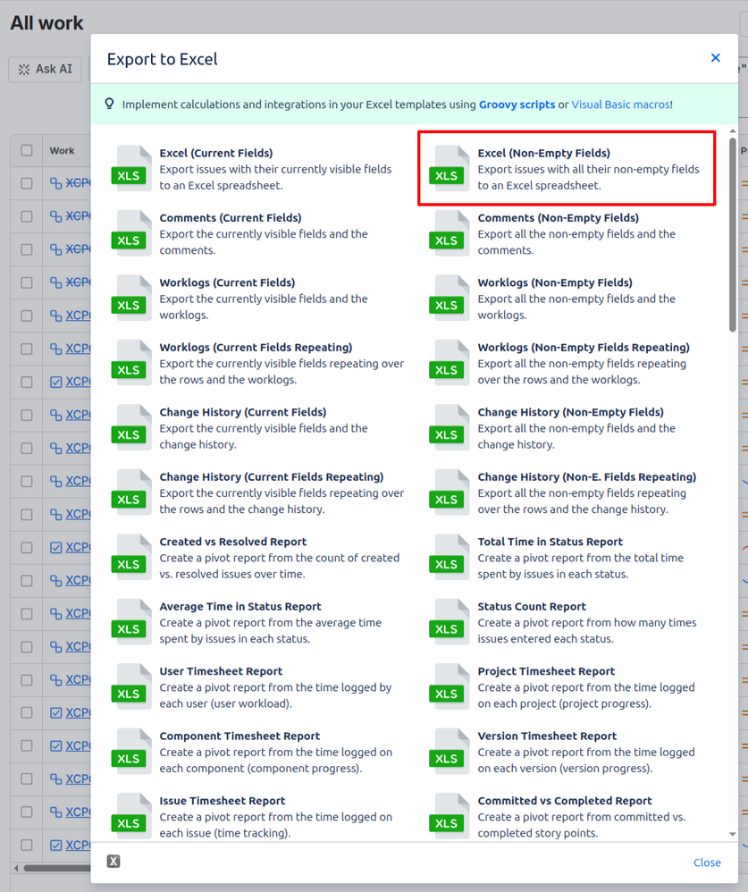

There is a "Non-empty fields" export option offered by the Better Excel Exporter app.
You can run this on any work item list resulted from a JQL search, and it will collect the fields which has a non-empty value for at least one of the work items.
If you want to execute this in a project, just run a JQL query like "project = FOO" and choose the marked option:
It is super-easy to use, just give it a try.

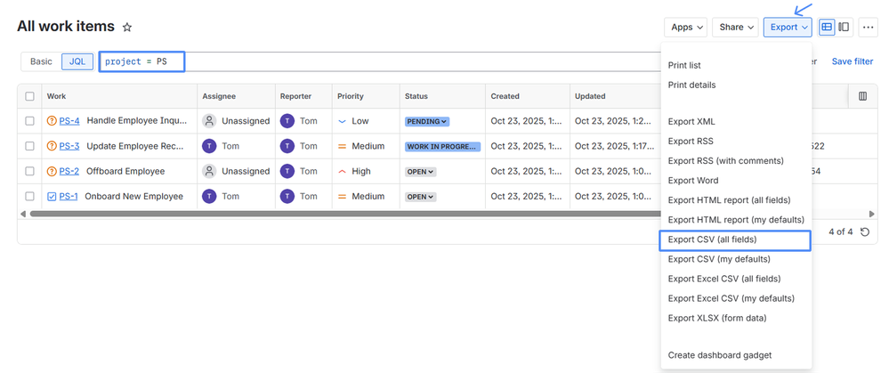

  1. Go to Filters →All work items → Advanced Search (JQL). Use a query like:  project = PS (in this case, it's a People Support project from JSM). Then, click Export and choose CSV (all fields).Frame 1 (12).pngYou'll get a file with all visible fields and their values for the requests in that project.
    Note: It only includes fields present in those requests, not every configured field in the project. Also, it doesn't include the history of field changes; it only shows the latest data.

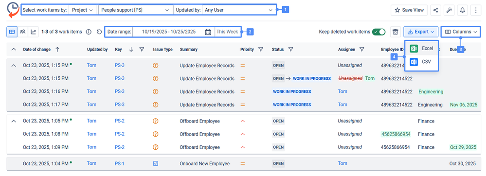

  2. Try Issue History for Jira app from SaaSJet team. Using it, you'll get a complete overview of all fields used, including custom fields and their changes over time.
It helps you:
  • Track every field change across your JSM projects.
  • Export reports to Excel or CSV.
  • See who changed what and when exactly it happened.
After installing the app, open it and select the work items for the required project from JSM (e.g., the People Support project). Also, you can choose the exact updater and date range needed. In the Columns menu, select all the needed fields (e.g., Employee ID, Department, etc.). Export the report in Excel or CSV formats.
