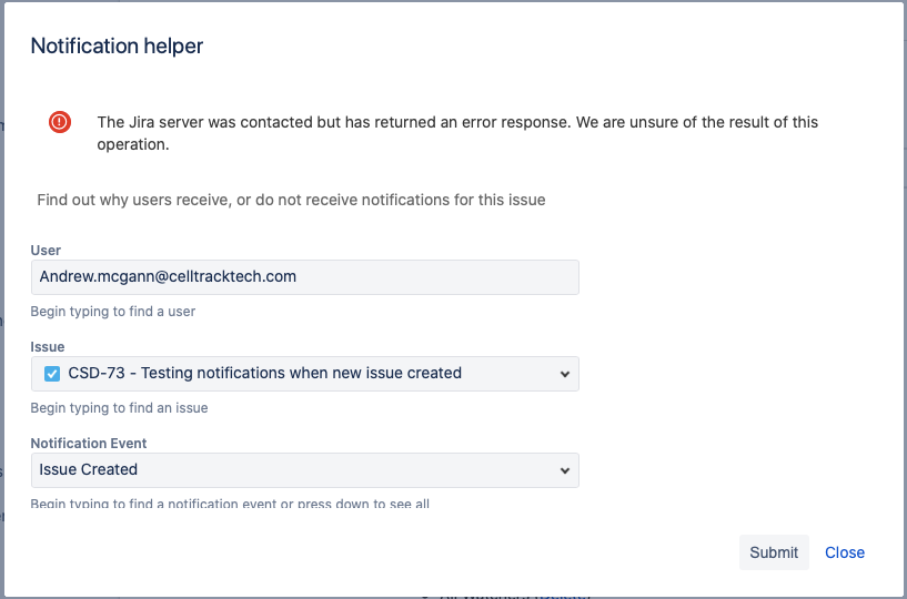

This is a classic Customer Service Desk project. Everything appears to be set up correctly, but no notifications are being issued. I used the Notifications Helper to try to diagnose the issue, but I received the following error message: (screenshot image)Screen Shot 2020-05-21 at 11.19.13 AM.png

The notification scheme shows the email address to be used in sending emails.
Is this correct?
Is there any project sending notifications that work fine?
Did you verified the email handler setting from global administrator configuration?
