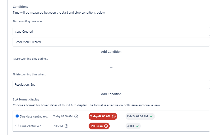

How do I stop the Time to Resolution clock when the ticket is on a certain status
HII NEXT
October 30, 2024
5 votes
Samuel Gatica _ServiceRocket_
October 30, 2024
Hi @HII NEXT
You have to Set up SLA conditions
To create and edit SLA conditions:
  1. From your service project, select Project settings then Request management, then SLAs. All existing SLAs are displayed here.
  2. Navigate to the SLA that you want to update and select Edit.
  3. Scroll down to the Conditions section.
  4. Select Add condition under Start counting time when to set the condition for when the SLA should start measurements.
    • If you add multiple conditions, the SLA measures the time when an issue meets either of the conditions.
  5. Similarly, select the plus icon under Pause counting time when to set the condition for when the SLA should pause measurements.
    • This condition is optional. It may be used, for example, when you are waiting for a customer to respond.
  6. Select Add condition under Finish counting time when to set up conditions for when the SLA should stop measurements.
    • SLA measurement will be stopped as soon as any one of the conditions specified here are met.
  7. Select Save.
Best regards
Sam
