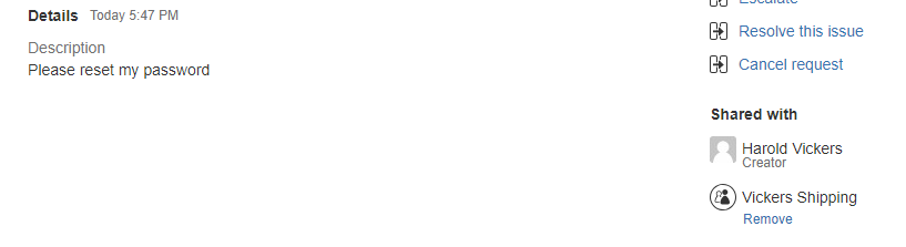

They cannot remove the organization from the database, but they are able to remove it from the view for the incident on the portal. This propagated to the agent's view. It seems that this is related to "Restrict Remove Organization"

Harold Vickers
May 30, 2018
Hello Jack -
In the following screen shot from the customer portal, you can see the "Remove" option on the lower right:
