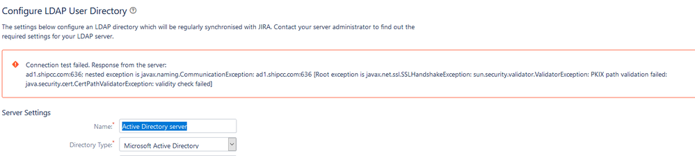

Hello @Cristiano Mariano thanks for the response. I was able to import the certificate successfully, and it said "trust this certificate?" etc., but when trying to switch Jira to use SSL over LDAP it still errored out with the same one as before.
I tried downloading the SSLPoke.class and running that to test if it could connect via SSL, but try as I might, the command never worked. Do you have a good example of using SSLPoke to test the SSL connection? All the variations from Jira articles failed for me (as in the syntax must be wrong, kept saying could not find "sslpoke.class".
Is there something else I can try for getting the server to use this updated cert? Thank you!

I have tried to use SSLPoke class sometime ago but could not make it work and did not investigate futher.
In SSL you have a Root Certificate and certificates below it, composing a chain.
One thing that you should try is to add every certificate in the chain to you Java installation. This link below shows how to get the certificates in Windows and Linux.
https://unix.stackexchange.com/questions/368123/how-to-extract-the-root-ca-and-subordinate-ca-from-a-certificate-chain-in-linux
Get each one of them and add it to the keystore, the same way you did for the others.
Try this and lets see if it works.
Hope this helps!

Thanks for the help. I don't know what I was doing wrong but I re-added my certificate with the chain again and then also referenced this from stackoverflow.
copy your certificates inside
/etc/pki/ca-trust/source/anchors/
then run the following command
update-ca-trust
We now can use SSL to LDAP now. Thanks!
